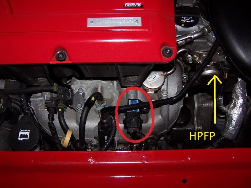

  #56
Posts: 11,719
SS's have 2 fuel pumps. The in tank electrical supply pump. Pressure of a good pump is around 50-60 psi.
The high pressure fuel pump (HPFP) is a cam driven mechanical pump. It is on the end of the engine by cylinder #4.
Cold startup you will see as high as 2200 psi from the HPFP. At a warm idle, I see around 300-480 range.
