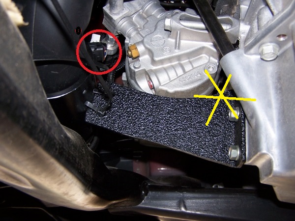

Not to be the pessimist, but that lower TMap wiring is a pain to get at. I hope your hubby is up to laying on his back to work on this. Unless you have access to a lift.
2 things to note. 1.See if you have the old style "crimped on" wiring install or the newer version that had the factory look plug-in harness.
The old style crimps are where most of the problems have occurred. Don't recall anyone posting up problems with the plug-in harness.
2. Most of the people having issues with the wiring rubbing on the compressor have been automatic transmission owners. The 5 speeds seem to have more clearance and seldom rub there.
Oh yeah. CEL numbers. You should get them pulled and post them up. Would hate for you be chasing down the wrong thing if the codes don't indicate a TMap/wiring problem.
Here's a picture of the lower TMap wiring plug(in the red circle). There is also an upper one on the manifold. Disregard the crinkle black plate. Your's won't have that part.
Attachment 45496
We do have a lift and it's a 5 speed. He's a bit preoccupied at the moment, just bought a chopper to play with. Sigh...... wish it hadn't gotten so chilly, I'd just ride my motorcycle to work!
