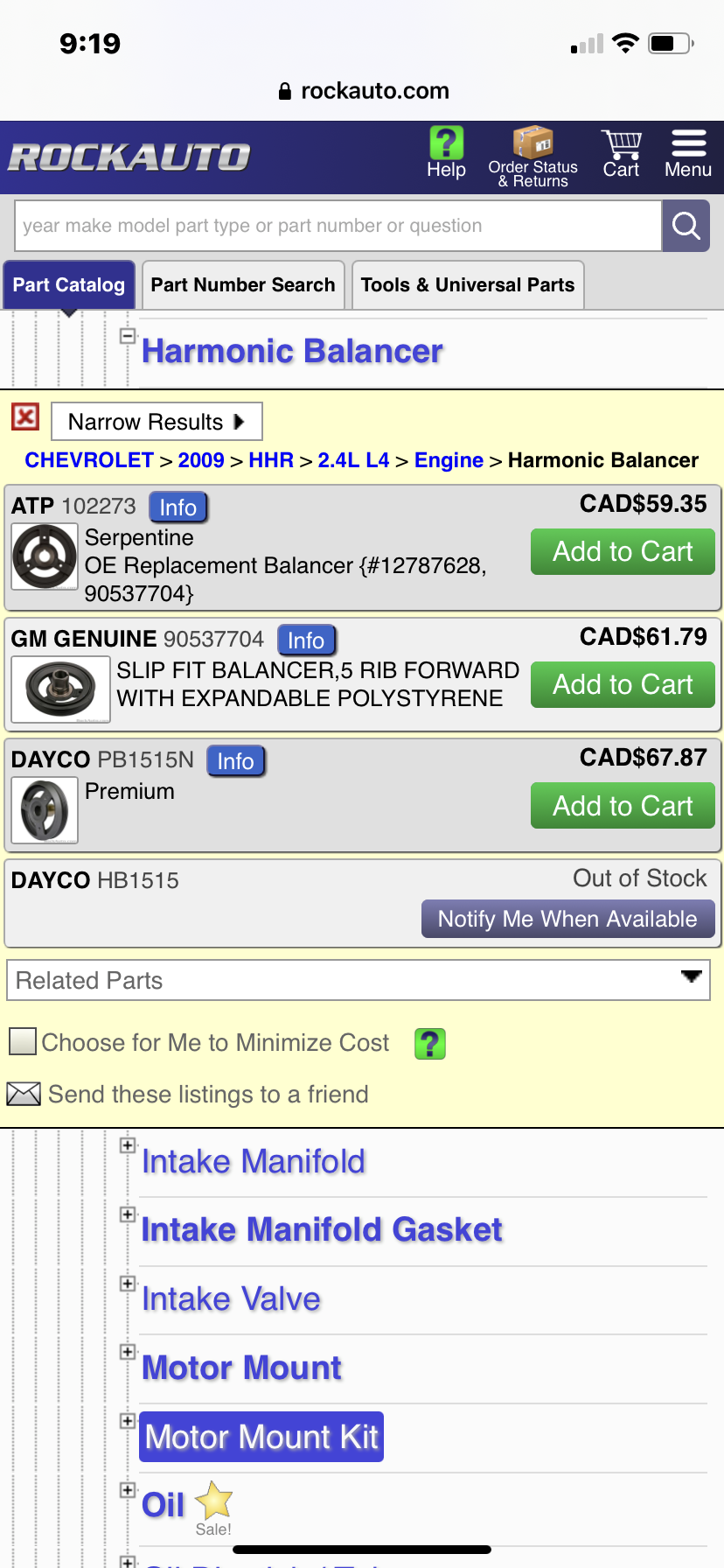

I watched that video before assembling everything. I did put a new crankshaft sprocket on but it wasn't the one supplied in the kit that is thinner. Has anyone ever experienced a faulty new balancer?
Old May 7, 2021 | 08:23 AM
Posts: 40,083
Perhaps the LNF balancer in an SS is different from the 2.2 or 2.4 balancer
The 2.4 has the same balancer
As the 2.0
but that doesn’t mean it’s correct.
