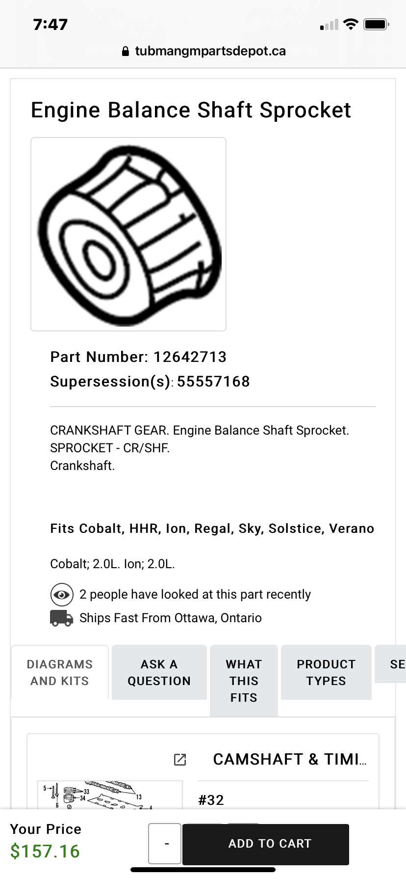

Every part number I've looked at for the balance shaft chain crank sprocket, says 2.0 2.2 2.4
https://www.chevyhhr.net/forums/hhr-...62713-a-62362/
Old May 8, 2021 | 06:50 AM
Posts: 40,083
I watched the video, severs times, it doesn’t really indicate a bent crankshaft, the centre of the crankshaft bolt appears to be centred, as does the outside edge of the pulley
According to this the sprocket marked 5557168 is specifically for the 2.0 LNF
