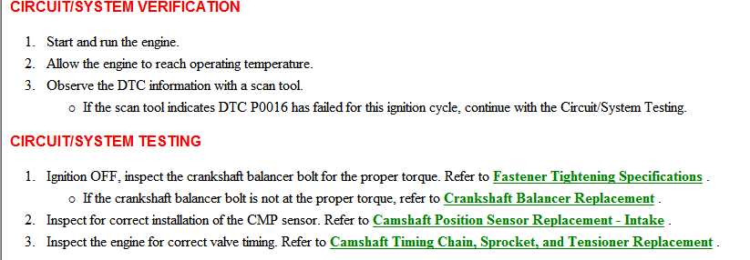

Old Apr 25, 2018 | 09:00 PM
Posts: 26,480
Did you properly torque the crankshaft balancer bolt?
Do you mean the CEL is on or that there is a history fault in memory. A history fault takes 40 cold starts to clear.

Old Apr 25, 2018 | 10:40 PM
Posts: 26,480
Then either the balancer needs tightening or your chain is off a tooth or 2.
From the shop manual:
First pass to 74 lb.ft.
second pass to 125 DEGREES
Guessing the torque is not good enough.
