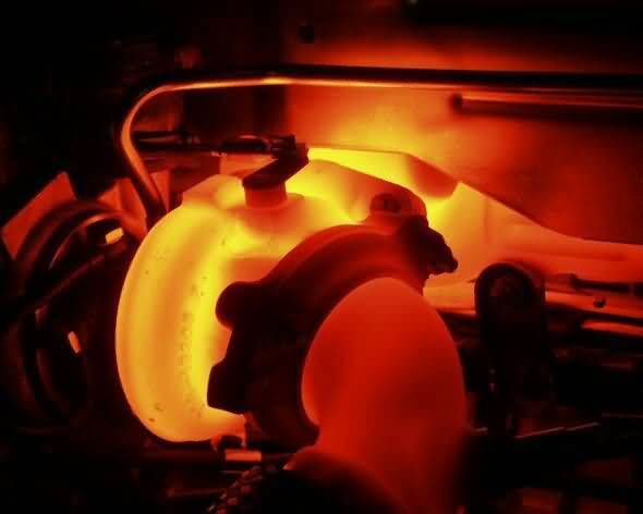

Yes, letting it idle a little bit is usually good. If you are taking long trips or running it hard, let it sit for even longer. It gives the turbo a chance to cool down.
The last thing you want to do is shut off the car when the turbo looks like this.
Granted that's an extreme situation, but it gives you an idea why. Just make it a habit to take it easy the last 5 minutes of your drive, and let it sit about a minute when you arrive. Also, when you start it up, let it settle around -20 in vacuum, it will love you more if you do that. If you take care of the turbo, there is no reason that it can't see 150k+ miles. If you hammer it all the time never let it warm up or cool down, you could be replacing it in 1500 miles. Take care of it and it will take care of you.
