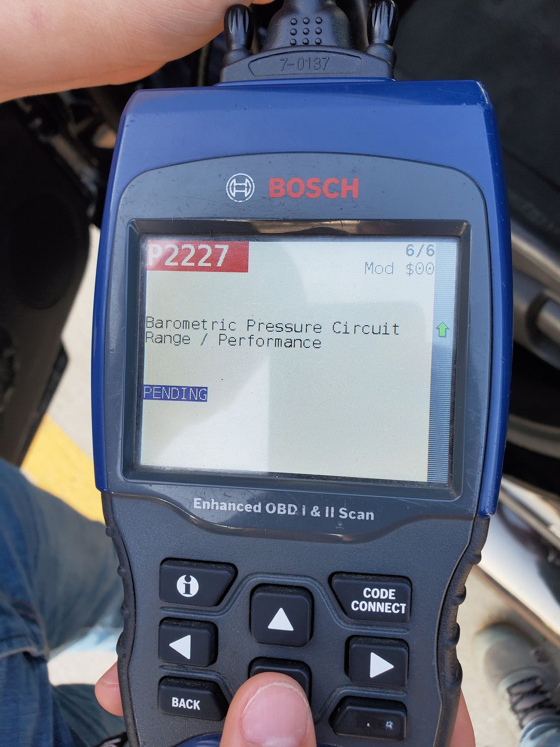

I'm having a problem where if I accelerate hard, I lose all boost like the Wastegate hangs open, problem goes away after turning the car off and back on. Then under hard acceleration it comes back. Had codes checked the other day can't remember the numbers but
It was an air intake temp code
An o2 delayed reading code
And a code for the non working barometer
Any suggestions on a fix? Before I replace everything for no reason, I just got the car last week so I'm uncertain of any aftermarket all I know is it has the ZZP cold air intake,
Any help would be appreciated

Got to have the actual code numbers (no descriptions) for us to try and help.
Stating the year model, mileage and any mods like the GMTU Stage 1 or aftermarket tune would help also.

Yes it has Bosch map sensors but I've never seen more than 9psi before my issue arises
I just ran to get the codes read as well
Old Sep 15, 2019 | 07:22 PM
Posts: 26,539
One of the MAP sensors is malfunctioning; probably because a wire is compromised.
Since you have GMTU that means the splices may be bad or the lower TMAP did not get rotatyed and it is banging into the AC compressor.
Somebody messed with your steering column that didn't know what they were doing. It needs to be calibrated.

The C0460 and U2143 are both history codes that have not recurred so either disconnecting the battery or 100 key cycles should clear them. They are not causing problems that you describe.
