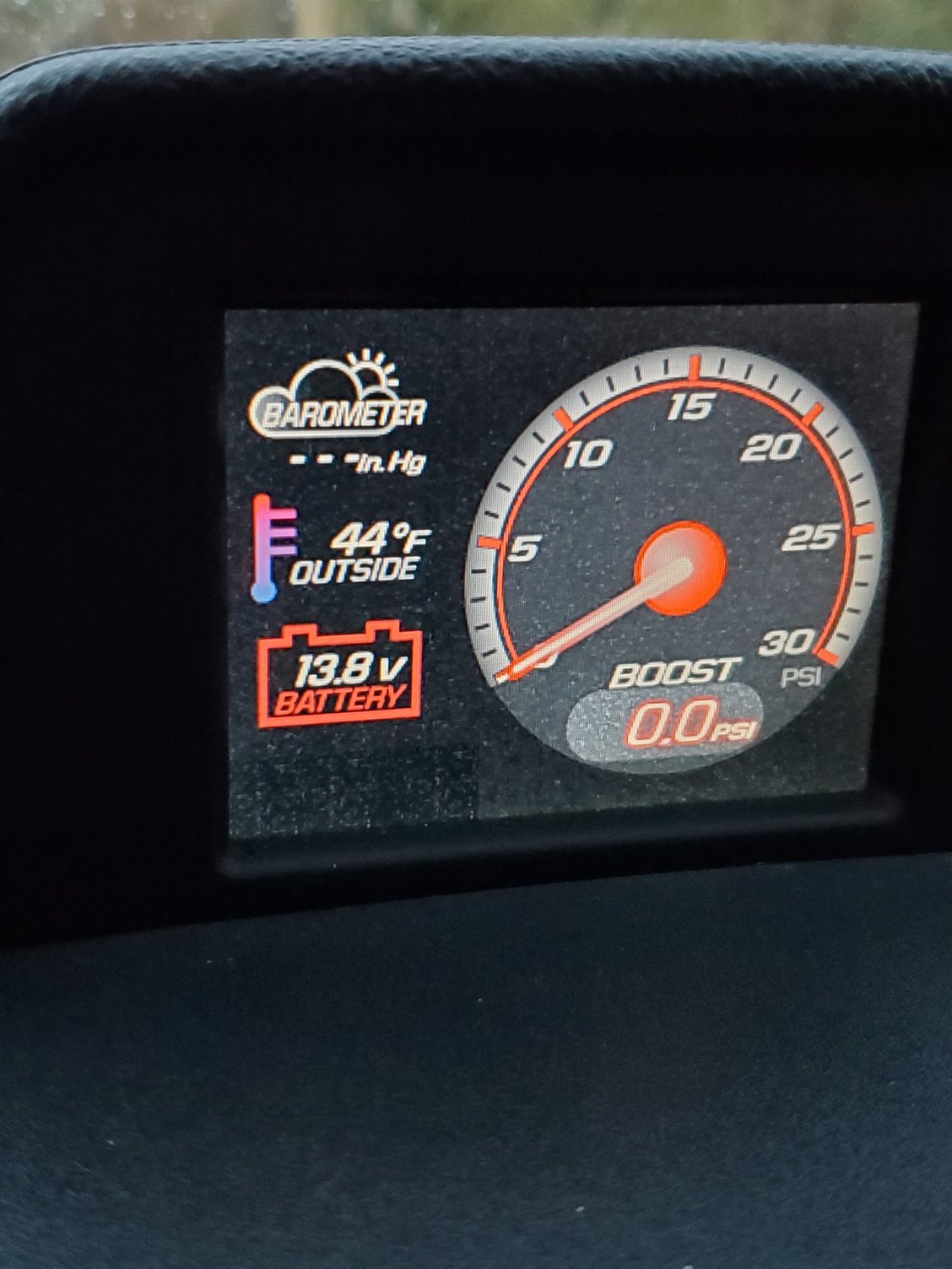

Only thing I've really noticed is before the sensor change the "barometer" in the car wasn't reading and it did work for about 10 minutes after the sensor change and now back to flatline

The baro reading comes from the TMAP, So we are looking for crossed wires or bad connections. That is a bit of data that the ECM uses to compute boost.
