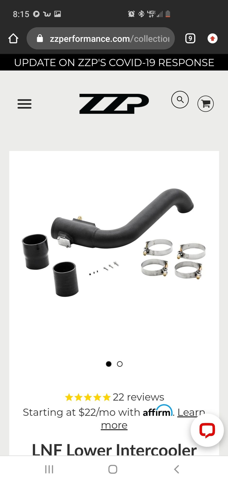

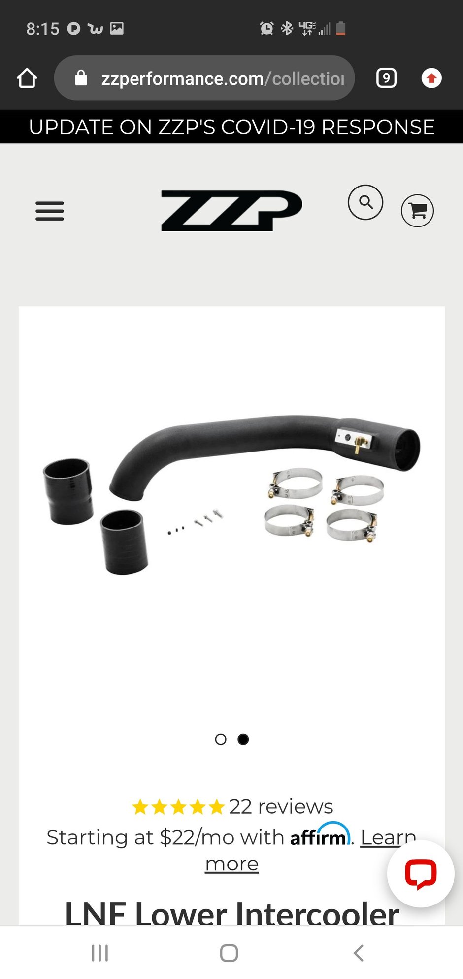

Boosting issues continued
2010 SS 5spd
just replaced intercooler and charge pipes to fix an underboost condition, and now i still have no boost and the turbo is fluttering badly car struggles to drive past 4k rpms the RPD claims the inlet air is 156° with no fluctuations and cooling fan is running non stop. I've already disconnected the battery a handful of times and cleaned MAF, both MAPs and plug n play connectors.

That code is the lower TMAP sensor again. Did the new sensor get turned?
For the record, removing the small bump does NOT allow the sensor to be turned 180*. The anti-rotation bar must be removed for that. It is molded into the lower charge pipe.
I considered turning mine 180*, but I suspect that doing so would put the connector into the fan housing. Here is how I dealt with the TMAP sensor.
https://www.chevyhhr.net/forums/how-...ive-way-62943/

Justin3315's Avatar
Joined: 09-15-2019
Posts: 25
From: MO
I got the full zzp kit

Borrowing donbrew's turban... That means that the new charge piping relocates the lower TMAP sensor out of harm's way?
You said that you got new plug and play connectors 5 months ago. Did you rotate the sensor at that time, or did you just let it continue banging into the AC? Or maybe you haven't driven it since then?

Posts: 25
From: MO
The new one positions the sensor well out of harms way directly below the Throttle body
