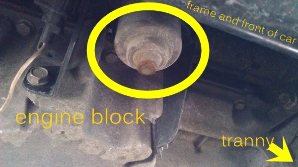

I read what was posted here of the TSB. I just got the car Saturday, so I don't know how long it has been doing it. I don't know what to look for to tell if the pump is installed. I'm pretty sure it isn't since the dealer said no brake work showed up in the system for my car. Any description of the pump or pictures might help.

If you have the tsb package you will see this motor from the under side.

I think that I remember somebody asking pretty much the same question recently. I vaguely recall pics included.
Give the SEARCH a try.
As if by magic!
Old May 6, 2014 | 08:00 PM
Posts: 40,083
I found this thread using the search window, www.chevyhhr.net/forums/showthread.php?t=44863
have a look at post #2

Thanks for all the info. I did search, but was not using the term vacuum and missed it.
It doesn't look like mine has it installed and I will bet it is very expensive to purchase. Looks like this is a safety hazard due to a design flaw. I have warned my wife to not get in a hurry in the morning for fear of no brakes.
