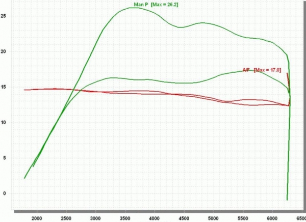

I have seen this basic chart a couple of places, and I think it is the BSR tune. A/F is steady, so the injectors can handle the extra fuel flow required at high boost. Obviously 26 lbs at 3500 means major torque increase. The engine is very strong, I would say go easy on the trans and clutch though (IMHO). Green lines are stock boost and after tune. Red is A/F stock and after tune (ignore the 17, that is artifact of lean at fuel cutoff at redline).

Both the Westers and BSR are good tunes and are quite reliable when used
with proper high octane fuel. I have talked to research labs working on various versions of turbo ecotecs and at stock boost levels, the LNF engine
is loafing along. I can email to this group a couple of pages of a SAE paper
on the LNF motor where they talk about things like salt chamber pistons and their oil circulating channels which lower piston temps. paper says it was
done for future performance increases. Similar comments made in fuel flow
section of paper. Engineers at these R&D centers have 450 hp versions
of LNF running with good results.
Of course, anything can happen but I would feel very good about either
of these tunes that add "only" 60-70 hp
