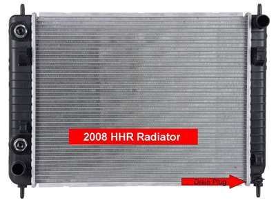

where is the radiator drain plug on these cars or do they have one --been taking the lower radiator hose off which is a pita in itself -- having to flush multiple times to get the oil residue out
Old Jun 29, 2021 | 03:23 PM
  #37
Posts: 40,083
The rad drain is down on the passenger side of the rad facing the engine
It’s conveniently placed above the v shaped brace allowing the coolant to spill everywhere, so make sure Fido isn’t around to lick it up! Not good for animals!
Old Jun 29, 2021 | 08:23 PM
  #38
Posts: 26,533
Actually the plug is not supposed to be removed; It is a spigot and the fluid drains down the pipe that you think is only the mount.
