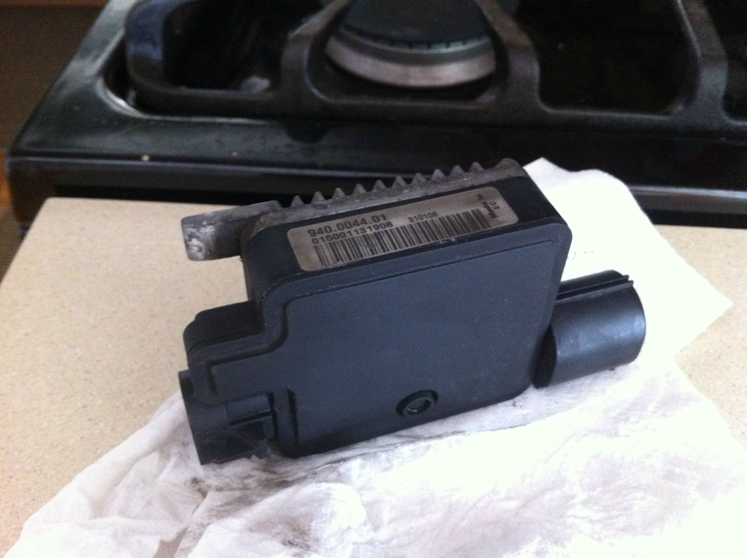

Ok got the motor of the fan tested by grounding it and connecting it to the fuse box, turns on like a charm and works well, must be the module but I want to test it......any way?

Pics of the part, I cannot find this anywhere on repair sites!?!?
All the numbers on the bar code come up with ZERO google results. Anyone know what this is called? I thought it would be the "fan speed control module" but nothing comes up anywhere.

I don't mean to be rude but trust me I've checked the coolant and the AC clutch works fine. It is this pic above that is the issue since I plugged the fans in directly, bypassing this and the fan worked fine.
Now if I could only get a part #

Got it,
ACDELCO Part # 25845280 More Info GM Original Equipment
Category: Cooling Fan Control Module
Cheapest is on Amazon for $93 but one left, all the rest are $125+!!!
