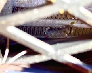

I hit a deer last night, and after impact the engine started stumbling and the icons on the dash all lit up.
After several stumbling restarts, the engine started up,but the CEL was on, and I have no boost with a P101 mass air flow code.
The engine idles at 10 on the vacuum gauge and bounces between 8-12 with a rough idle.
Would this be the symptoms of a damaged intercooler????
I am new to Turbo problems, so any advice would be appreciated.

Sorry you’re SS got damaged, are you alright? Looks like there’s a hole in the intercooler. Perhaps time to upgrade to an aluminium on from ZZP?

Sounds like it is a vacuum/ boost leak somewhere. The plastic end tanks of the intercooler are a known weakness. Is that a hole in the intercooler?

It looks like the fins are ripped back in the area shown in the pic, but I don't see any hole in the tubes, but hard to say without getting a better look at it.
It is leaking boost when I step on the gas, the gauge just goes to "zero" and that's it.

Could be an end tank damaged, they’re only plastic.

The P0101 kills the boost.

Could the impact have messed up the mass air flow sensor?

More likely that the vacuum leak is causing the P0101. Only 10" of vacuum at idle, should be 19" or 20".

Apparently the Potential causes for P0101 trouble code may include:
Dirty or contaminated mass air flow sensor
Failed MAF sensor
Intake air leaks
MAF sensor electrical harness or wiring problem (open, shorted, frayed, poor connection, etc.)
Clogged catalytic converter on some models (GMC/Chevrolet mainly)
ah, Intake air leaks , if the intercooler is cracked there’s the intake air leak.
