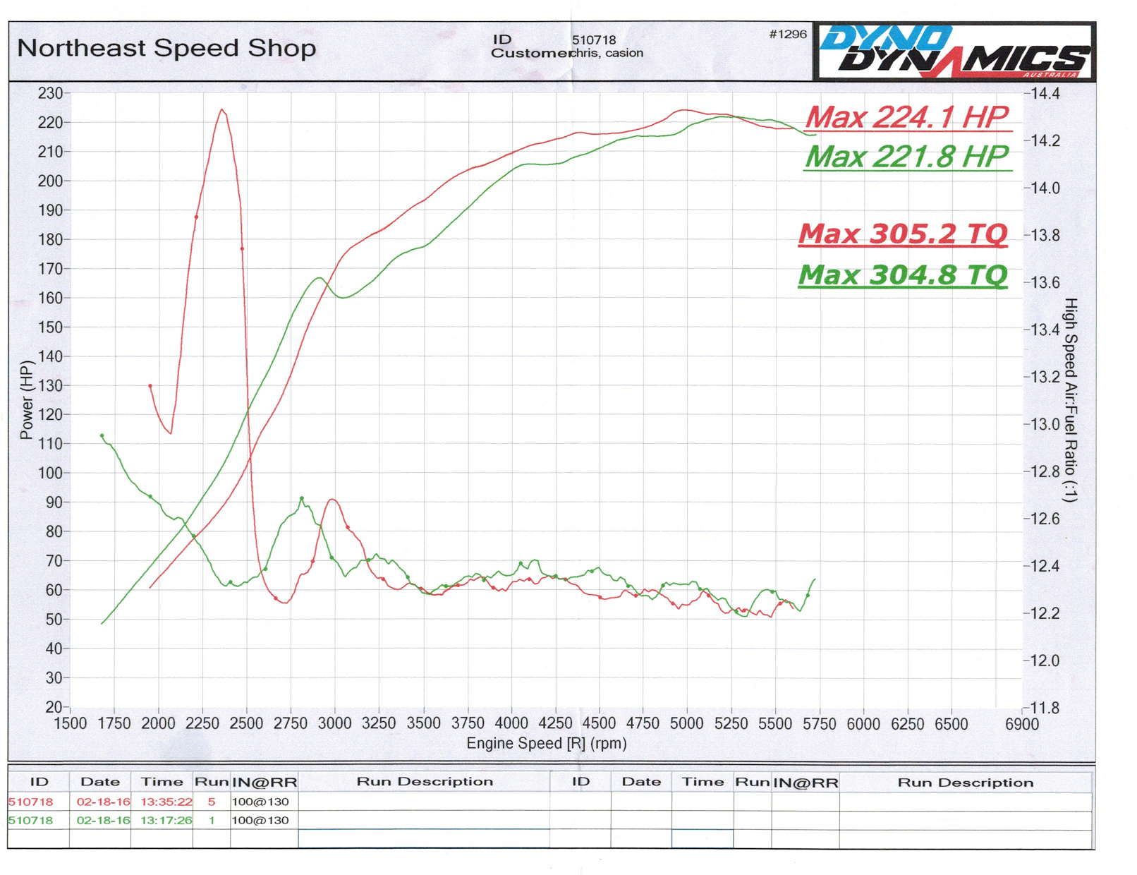

After some great service from Hahn Racecraft, I am unfortunately, looking at a rather disappointing dyno.
Now, I'll preface by telling the forum what the owner told me: his is not a "feel good" dyno, but using the whp he asserts the 1/4mi times will be accurate (i.e. no rosy-colored glasses here).
He also said the tune is "solid" and "safe" and he didn't think he could squeeze much out of it. Further that tuned Cobalt turbos (this was his first HHR) that had stock internals and turbo tended to get 205-220 whp, so mine was a little stronger than he expected.
Still, the upshot is an estimated 270 crank hp and 370 crank tq, but with a pretty solid drop off from the 3000 RPM torque peak (thus the low peak HP). The dyno graph is pretty clear.
With full 3" DP to exhaust tip (test pipe), metal charge piping, GMS1 followed by Trifecta mail order tune... I expect more like 350 hp - 350 tq crank or 290 hp at the wheels.
What am I doing wrong here? It's not heat soak: he did 10 runs and only on the 10th did he see a drop in the peaks. Runs were consistent even with the stock intercooler. I use 93 oct, always. It's a relatively fresh K&N... I just don't get it.

It still feels fairly strong, compared with before. I have the Trifecta on the "Competitive Mode" and GMS1 on the "regular" mode (I'd have to confirm whether "Traction Off" is GMS1 or Trifecta). There's a very notable difference between default and Competitive. Clearly something is happening. Even GMS1 should put down closer to 240 whp, but let's say his dyno is "pessimistic", I can buy 224 from GMS1... But for a tune that is noticeably stronger? Something doesn't feel right. And the torque fall off... I don't believe our turbos are so "wheezy"... Something feels off here.

The run charts
Here are the charts I failed to attach previously.
Attached Thumbnails Disappointing dyno post modifications; comments?-hpandtq.png   Disappointing dyno post modifications; comments?-hpandaf.png

Something I'm not understanding here, is this calculated in wheel RPM or engine RPM? Torque and hp should crossed at an engine rpm of 5252. Torque and HP are linearly related by the formula hp = (tq*rpm)/5252 which is why the lines always cross at 5252. Your are crossing at 3750
