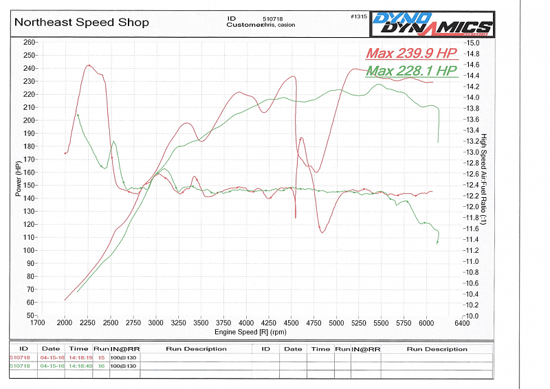

After putting in a K&N drop-in in there I'll run it for a week and bring it back for another dyno pull. The shop owner sounded dubious (as in "don't expect much") but I'll post a pic of the plugs today and maybe it'll make sense to more seasoned turboers. I've never seen a plug like that but of the F/I vehicles we've owned, this is the only one we've held on to long enough for extended maintenance that wasn't a low pressure turbo (SAAB 900 / 9-3s and a Mazdaspeed MX-5 "Miata")
Well, some update. It appeared to be running better, but on the dyno it went sort of nuts. A/F was bouncing around and the computer was clearly not happy about something. I don't know if it was the non-standard plugs or what.

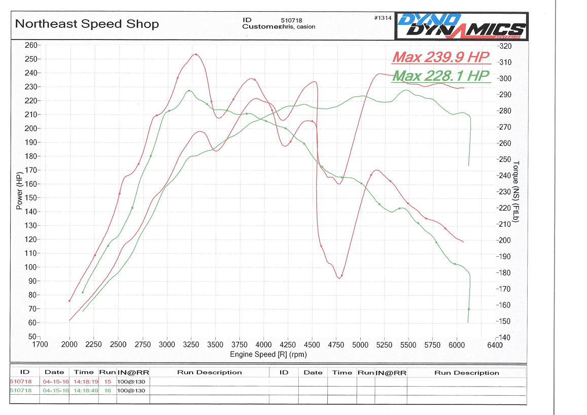

While the peak numbers were better (~240 is about 280-290 crank HP), it's still well below expectations among this crowd. Best Tq peak was 315 at the wheels or ~370-380 depending on the driveline loss (I use 15% so the lower end of those ranges is my guess, but I don't know what's appropriate for the F35).

MPG went up ~1 (at least that much is empirical) and overall power delivery seemed to improve. "Sportish" sedans that required 3/4+ throttle to beat out are smoked with far less pedal effort on my part (high 200 low 300 hp sedans and such). But the dyno behavior was so erratic, so I'm left scratching my head. I have not been noticing that type of behavior on the road. But we know how unreliable our desires and impressions are vs. reality. That's why we have calibrated instruments!
