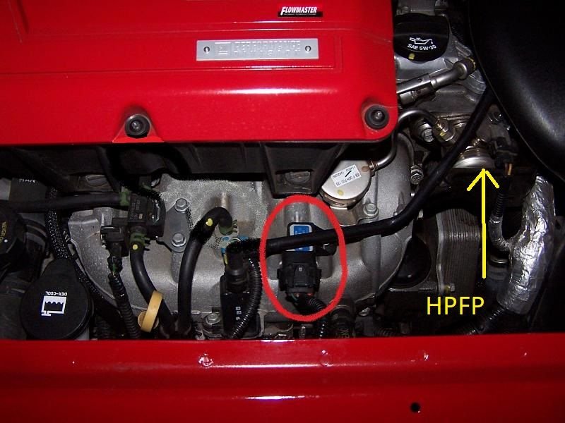

Do you have blue Bosch 3 bar sensor on the front top part of your engine? Just above the fan. If it's not one of those, you don't need 93. The GMTU came with those blue 3 bar sensors if it's tuned with that kit.
Okay will check and post the result. I have no idea but will check. I truly love my SS and it runs well besides the occasional sluggishness. I think it may just need some proper tune up. Currently it has the stock air filter and I heard that something like K&N can help but I also heard that the oil on the filter can be an issue.
I wonder if this is what you are talking about. I have attached pictures. It does say 'Bosch' at the top.

Posts: 11,721
No. He was talking about this Bosch sensor (red circle). It's called a Tmap sensor.
