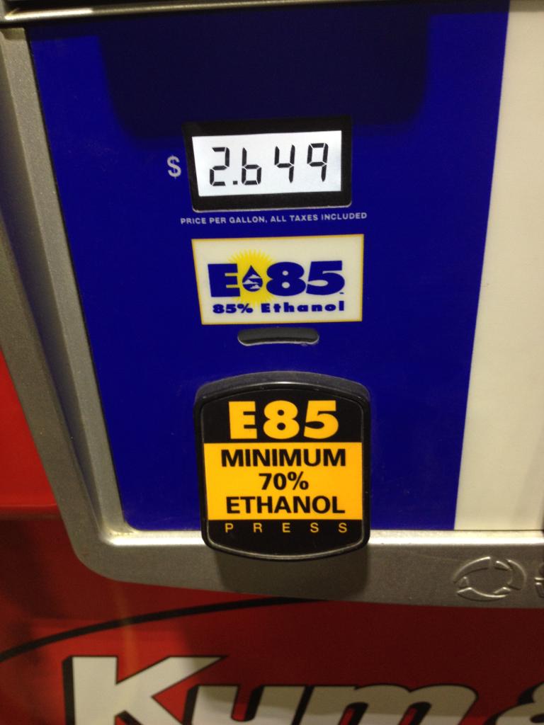

So I loaded up the e47 tune, and headed to the nearest e-85 station. When I got there I saw this:
With a "minimum" rating of 70% ethanol, should I make the fuel mixture like 55% e85 and 45% 91octane?? Or should I just do the 50/50 mix regardless??
Just go 50/50...
The ECM will take care of it...
I used to test my mixture, E70 is fine...
I've stayed with a 50/50 mix for 5 years now, the ECM will easily adjust , for E70...
