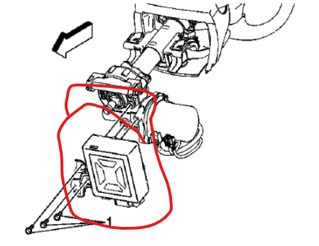

Oldblue Jan 4, 2024 12:38 PM
What about the steering control module?
fastsuv Jan 4, 2024 02:09 PM
I could ask for it.
Anything else I should ask for?
Steve
Oldblue Jan 4, 2024 02:28 PM
Someone was looking for one a couple of days ago
https://www.chevyhhr.net/forums/ss-s...a-66064/page2/
and these folks
https://www.chevyhhr.net/forums/prob...-module-64680/
donbrew Jan 4, 2024 03:20 PM
The steering control module should be a part of the steering column assembly.
https://cimg3.ibsrv.net/gimg/www.che...ee4c5a96a7.png
