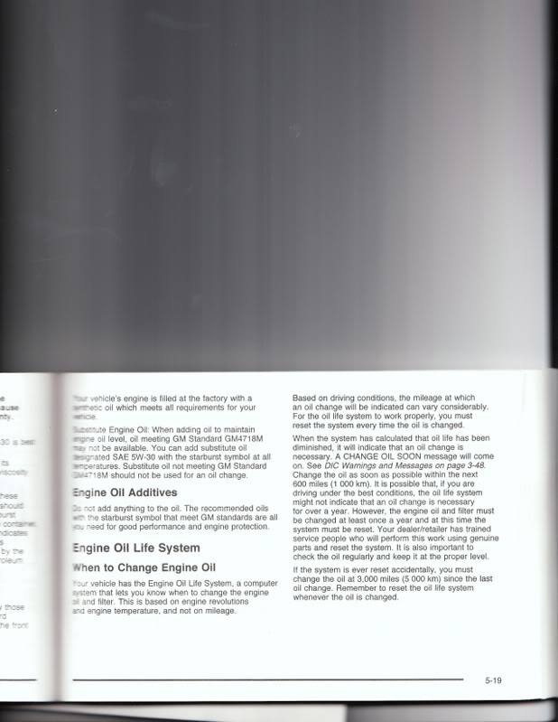

Heres what the manual says about the oil life indicator...

2nd method.
1.turn the ign key to on/run with the engine off
2. fully press and release the accel pedal slowly 3 times within five sec.
3. turn the key to Lock/Off, then start the engine
