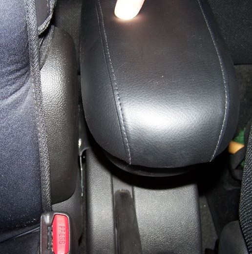

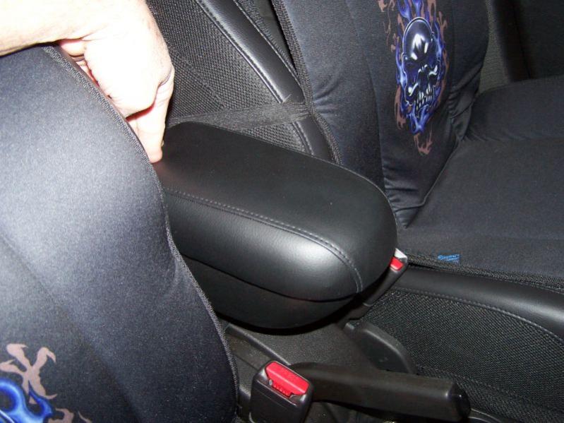

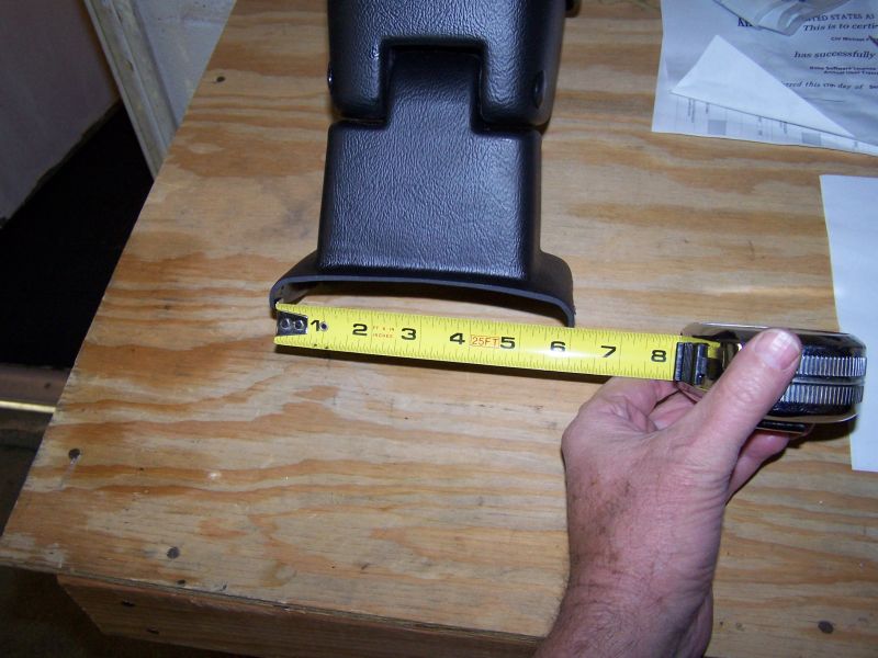

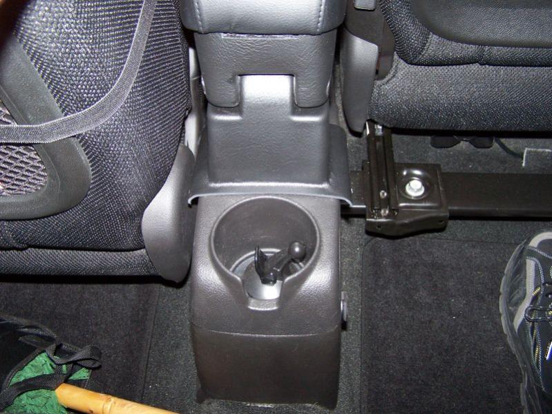

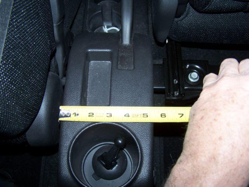

Red face well, the console/armrest is a no-go.
I did some initial measurements after I received this, and the console in the SS is 5 1/4" wide while the armrest/console is 5 3/4" wide where it would mount. Plus, the SS console angles down in the front by the hand brake. The front of the mount for the armrest angles up, so that when it is flush on the console it angles way down in the front. I've got some pics, just need to re-size and crop.
As you can see, this mod can be called a bust. Unless there is a way to heat-up and re-bend the sides of the armrest mount.

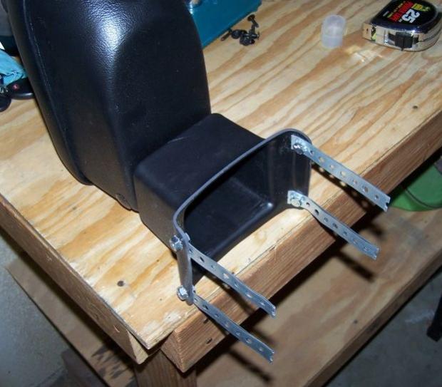

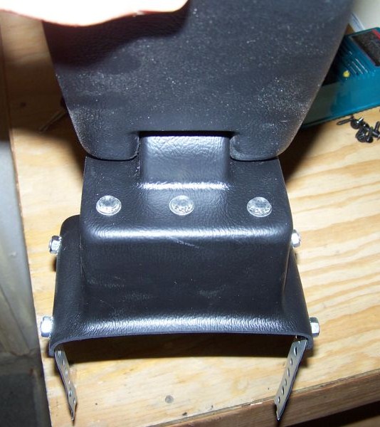

Wink I haven't totally given up yet.
My latest brain-storm is to trim the sides down to the 5 1/4" width of the console and use some strapping materiel like the earthquake straps that are on my home water heater. I would bolt the straps onto the inside of the arm-rest tower and then bolt the whole thing onto the car center console. I just have to find the time. Then, I could shim up the front of the arm-rest to get it to the height that would suit me. The big benefit of this arm-rest is that it folds back and upright, so it fills in the gap between the seats. It will cover up the little oblong depression next to the hand brake. I haven't figured out what to use that for, maybe to drop loose change into.

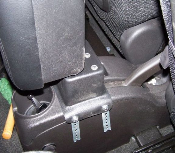

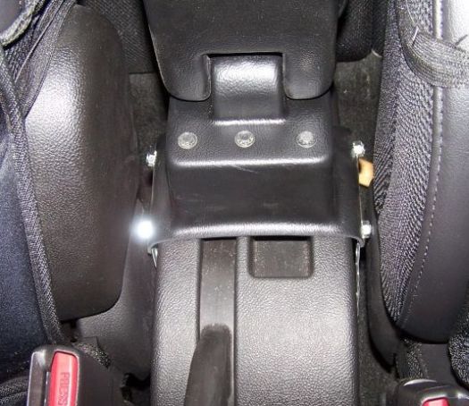

Red face Well, back to the drawing board again.
After popping off the top of the console in the car I found that the spots where I needed to drill holes are not conducive for that purpose. It's a good thing I hadn't cut off the sides of the arm-rest base plate yet. So, I'm in limbo again.
Here are some pics of my current problem. Both seats are hitting on the mount bolts with the arm-rest still 3/4" wider than the console.
Size:  46.9 KB Name:  100_0726.JPG
Size:  66.0 KB Name:  100_0729.JPG
I only stuck the big ugly bolts in there because of all the gap difference, and they would keep the arm-rest centered. Now I probably have no choice but to trim off the mount ears on the tower and bolt the straps further up.
