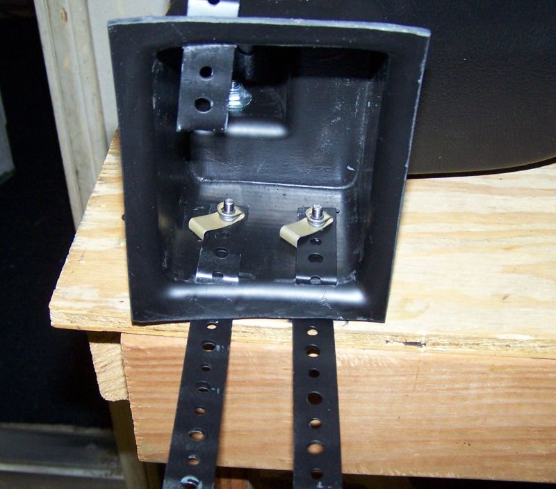

Talking Well, I've cut off the mount ears on the tower.
Now to mount this thing on the console I will need to mount the straps further up in the tower. Then I will use the screws that my mud-flaps came with to mount it on the console. So, the straps will be making a squiggly S-turn to go down the side of the console. Right now, I have it all pictured in my head. Once the seats are back in their normal position, the straps will be mostly hidden. I'll just paint them black.

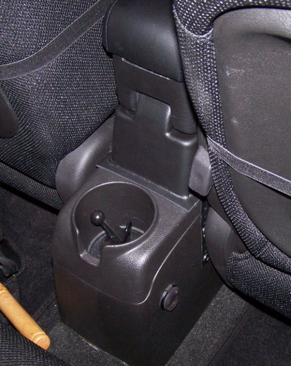

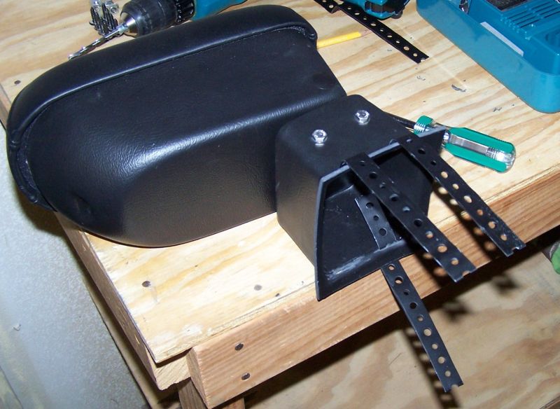

Talking Arm Rest installed, finally.
The deed is done. And, this thing is just the right height for me and I can even use the shifter lazy boy style.
Here are some of the work in progress shots. As you can see, I painted the straps a flat black.
[ATTACH]Name:  100_0732.jpg
Size:  79.9 KB[/ATTACH]

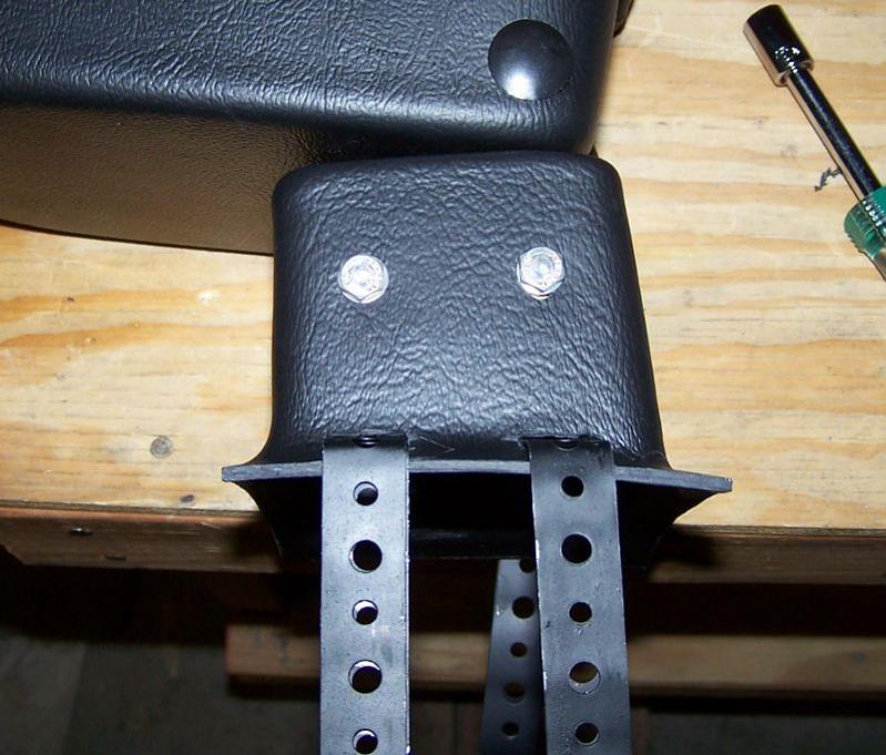

I scrounged some hardware from work, bolts and clip-on nut plates. I cut slots into the side of the tower.
Size:  87.3 KBName:  100_0734.JPG

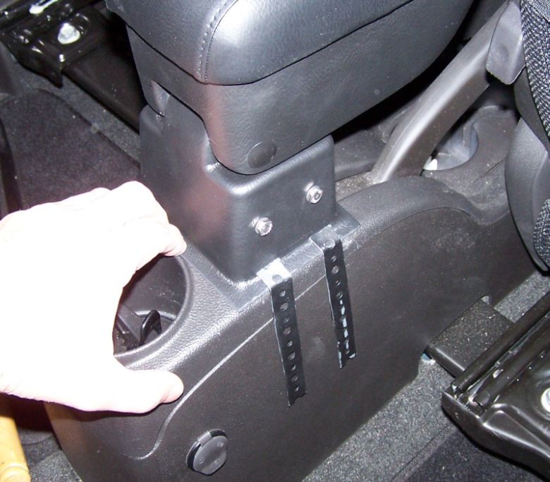

On the right rear strap, when I drilled the holes into the floor console, I hit some reinforcing plastic.
With the seats back in the normal position the straps are barely visible.
More pics in next post.

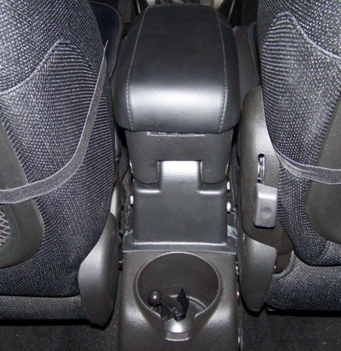

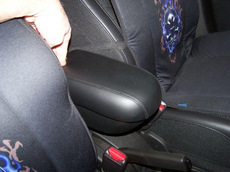

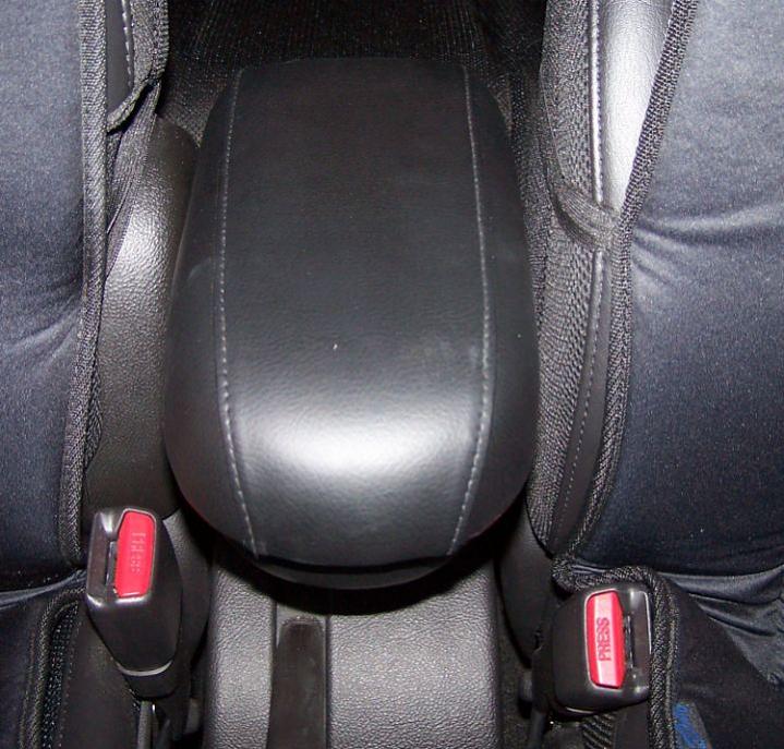

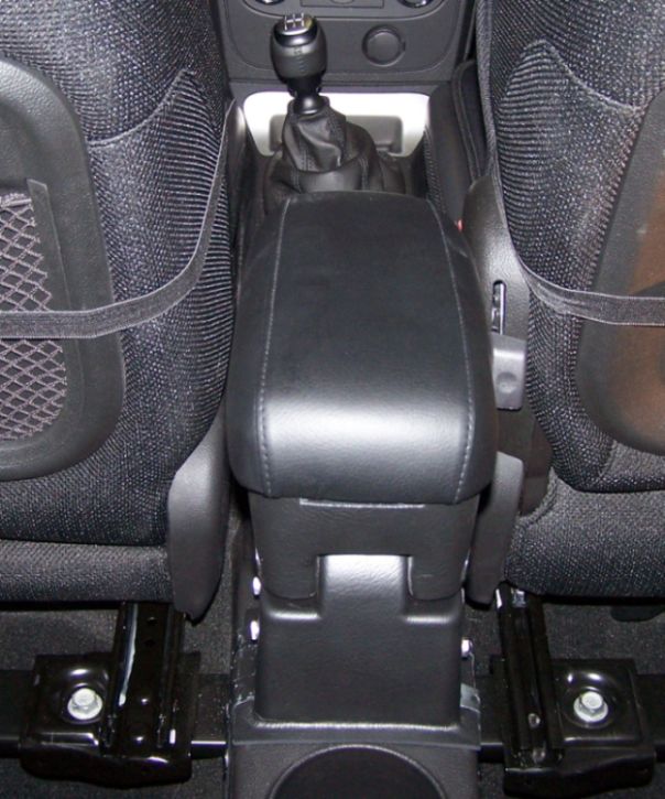

Talking More pics.
The arm rest appears to be off-center, but that is because the drivers seat does not have the arm rest lug on it.
Size:  83.3 KB; Name:  100_0738.JPG
Overall, I'm pretty pleased with the look and the new feel while driving.

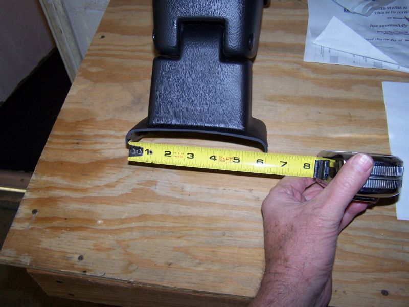

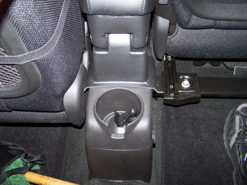

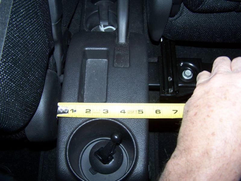

Originally Posted by pappa_smurf
I did some initial measurements after I received this, and the console in the SS is 5 1/4" wide while the armrest/console is 5 3/4" wide where it would mount. Plus, the SS console angles down in the front by the hand brake. The front of the mount for the armrest angles up, so that when it is flush on the console it angles way down in the front. I've got some pics, just need to re-size and crop.
Attachment 5954
Attachment 5955
Attachment 5956
Attachment 5957
As you can see, this mod can be called a bust. Unless there is a way to heat-up and re-bend the sides of the armrest mount.
