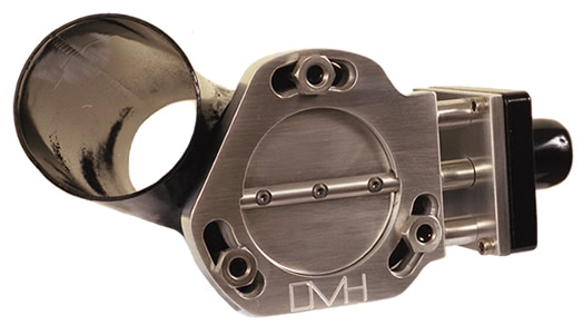

Really my exhaust isin't loud at all...But will be when I get home and install the DMH Exhaust cut-out....
