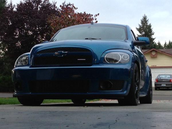

The stock suspension is stiff, but that one sounds broke.
My lowered SS rides softer than the stock suspension......
