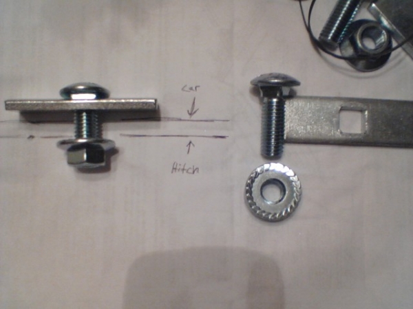

I'm very interested. I, too, have a hitch, but it is not yet installed to my SS. I wonder if there would be any way to safely shim the hitch assembly so it is slightly lower.

I think that would be the way to go. How does the hitch attach to the car?
Maybe get some square tube and sandwich it between the mounting point?? I was wanting to get a hitch for mine but wasnt sure if there would be clearance issues. I will definitely NOT cut up my bumper.

Now that you mention it paulBvtn, I should add that I have the same hitch as you. (Curt) I may break open the box and see what I need to shim it given that I can easily examine the hardware at this time. I'll post up anything helpful I find out.

Okay, here's a picture of the mounting hardware. It looks to me like slightly longer bolts are needed. On the paper behind the hardware, I diagrammed the assembly. The spacers would go between the car and the hitch. To maintain firm contact between the body and the hitch, I would think that a bar of metal spanning the bolt holes on each side would be preferrable to using washers which would leave a gap between the car and the hitch. I have no fabrication skills, so I'll see what I can find.
