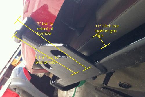

Okay, here is a picture from the underside of mine.
This is the Curt hitch on the SS, without trimming the bumper.
I'd like to trim it like others have done, but I was originally concerned that once I trim a hole, that the bumper will come down and cover up the hitch pin hole or near enough so that getting the pin in and out would be a hassle.
In this photo I've annotated measurments of the curt hitch I have.
You can just see the hitch pin hole on the side.
So, those that have trimmed and used a Curt, how does yours look?
Does yours come that far rearward on the car? (only 7/8" from hitch end to rearmost bumper edge.)
Where does your hitch pin hole fall?
I'm wondering if the design changed, or mine is mounted farther back than expected.
