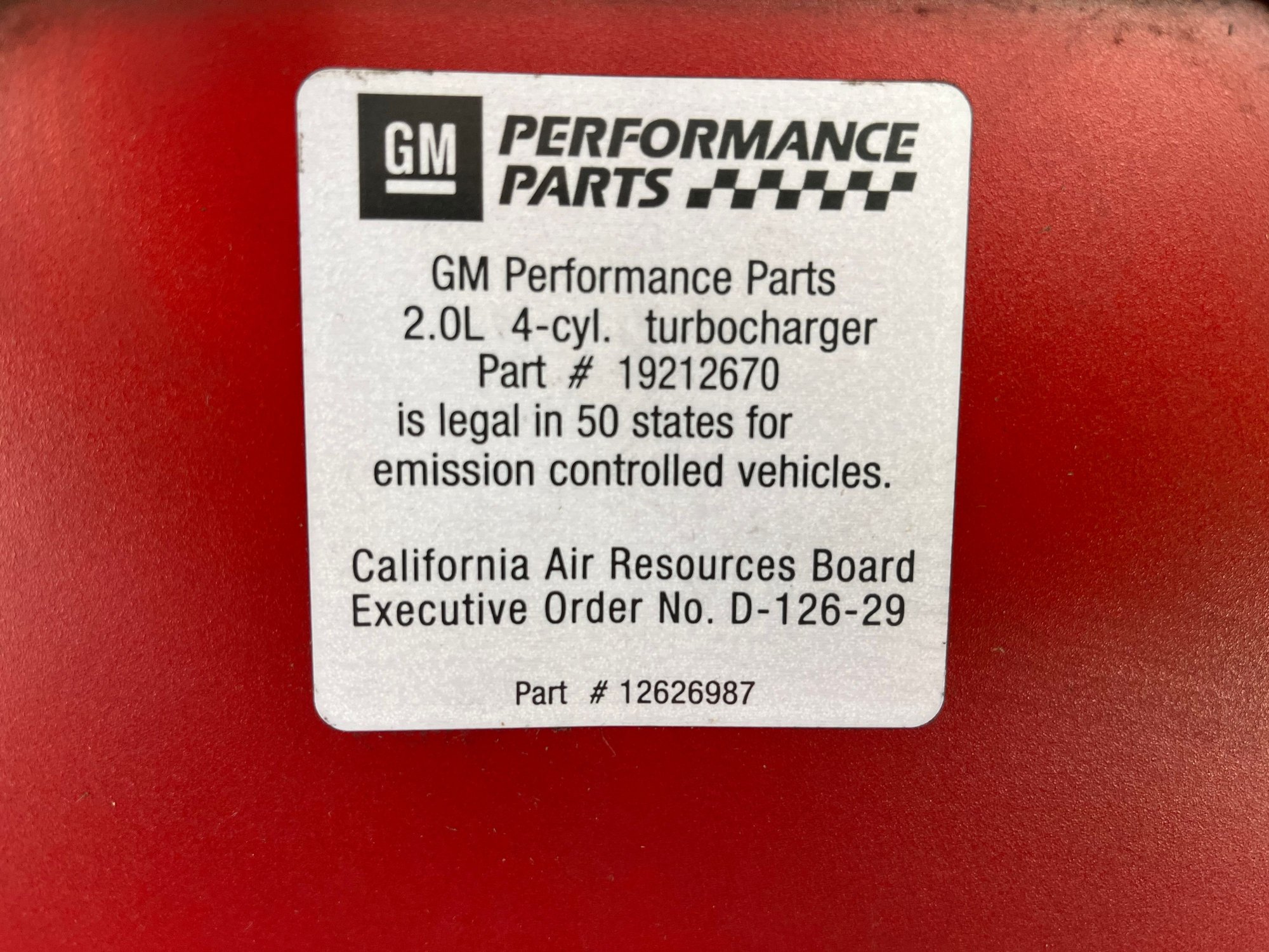

Old Sep 3, 2022 | 09:04 AM
Posts: 11,721
Here are the GMTU(Stage 1) stickers for the HHR SS. Thought I would post some pics since I couldn’t find any recent ones on the site.
Old Sep 3, 2022 | 09:34 AM
Posts: 26,543
I never noticed the date on the filler door. If that is what it is.
