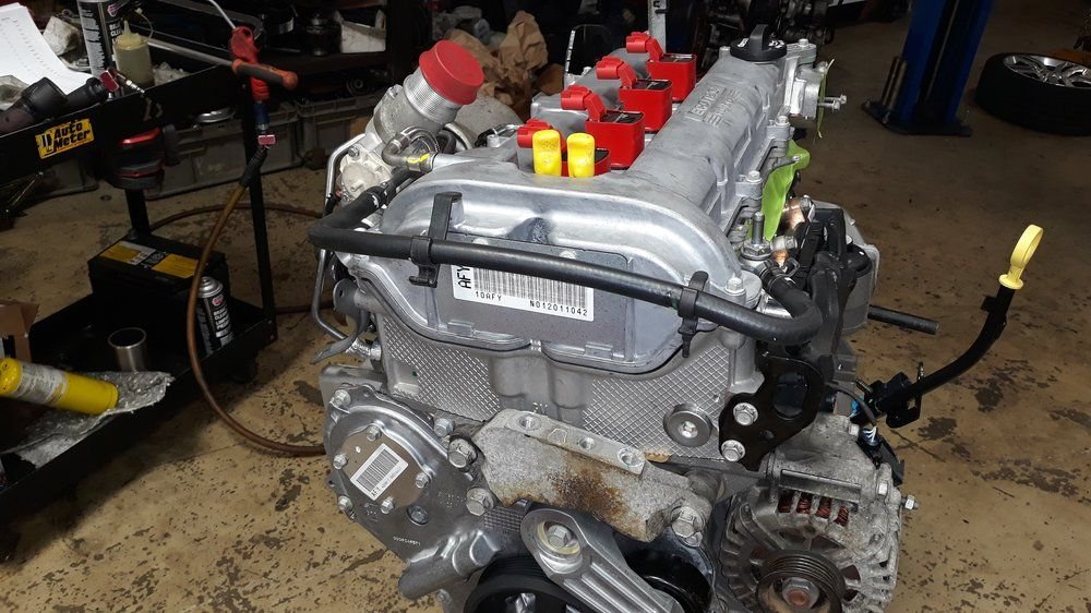

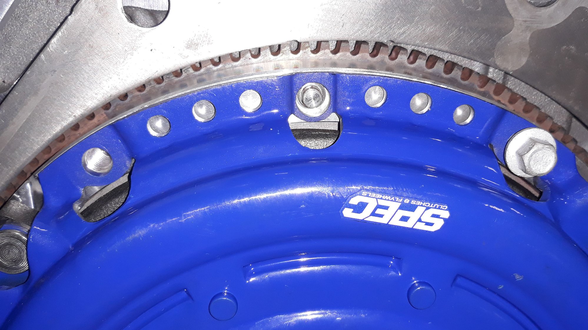

So got the swap started. Currently on hold due to spec stage 2+ clutch I got, holes in the pressure plate don't fit the dowels on the flywheel. Believe the dowels are 6mm on the flywheel but spec kit has 10mm holes in the pressure plate?
Spec and ZZP has assured me that this shouldn't matter, but I'm having a hard time believing that. Anyone have any knowledge on the subject?
Also, just for reference, tried the stock pressure plate on the new ZZP flywheel and it fit perfectly, dowel holes were the same size. I have an 08 HHR SS with the MU3 transmission.
Pics of progress

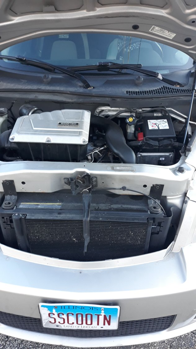

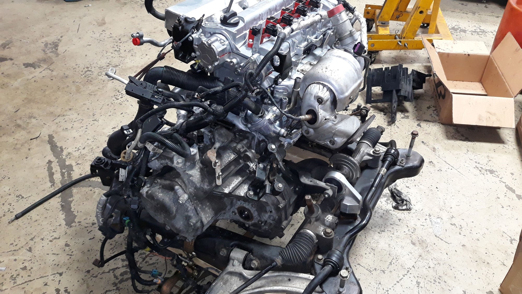

Old lnf gen 1
​​​​​​things were going pretty well, until the problem with pressure plate issue

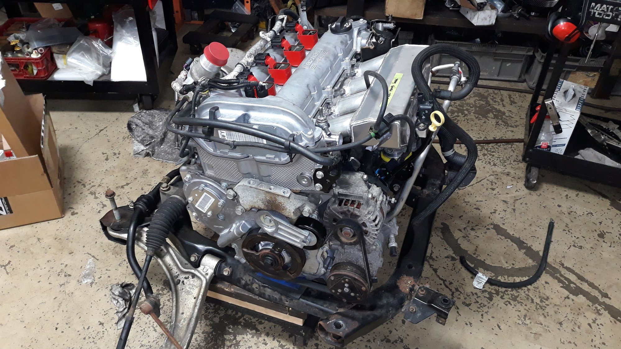

new ldk with rpm upgraded turbo and TTR intake manifold

Are you installing the front guide upper bolt as RJ did?
Old Mar 20, 2020 | 11:31 AM
Cat Man HHR's Avatar
Joined: 08-03-2010
Posts: 3,564
From: Lake Ronkonkoma, N.Y.
Are you referring to this ?
Thanks,
Yes. If you look at the 4th post, second pic down, it shows it in there already, if that's the same one that catman was showing up close?

Update:
Pressure plate dowel issue handled. Had to have new dowels milled from scratch as the ones spec sent me were 12mm stepped to 10mm. Spec wanted me to have the new flywheel milled to fit them, which would have limited my clutch options going forward to using the same spec clutch, which I wasn't willing to do. Needless to say, don't get the spec clutch for this, or you'll be opening up a can of worms to deal with. Next clutch will NOT be from spec, but hopefully I won't have to worry about that for some time.
Transmission installed, engine installed to the cradle, running some wiring for wideband o2, oil pressure, and water temp gauges, then going back in the car. After that I'm replacing the entire cooling system (hoses and radiator) and installing the Hahn intercooler and charge pipes kit, a little break in for a couple hundred miles, then rpm tune is getting booted up.

Posts: 40,097
Ok, this picture, it’s installed already
