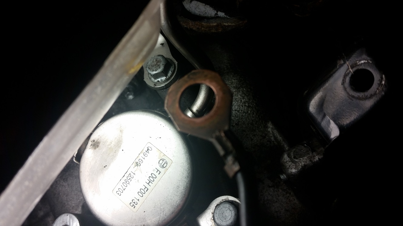

I recently purchase a 2009 HHR SS and replaced the head gasket and timing chain
I cannot find a home for this ground wire (it lost it's tag somewhere)
pic #1 = The end that needs to find a home - general location is high pressure fuel pump driver's side of the intake, would reach under the intake.

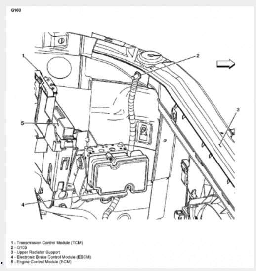

pic #2 = where the wire is connected ground location above driver side headlight -

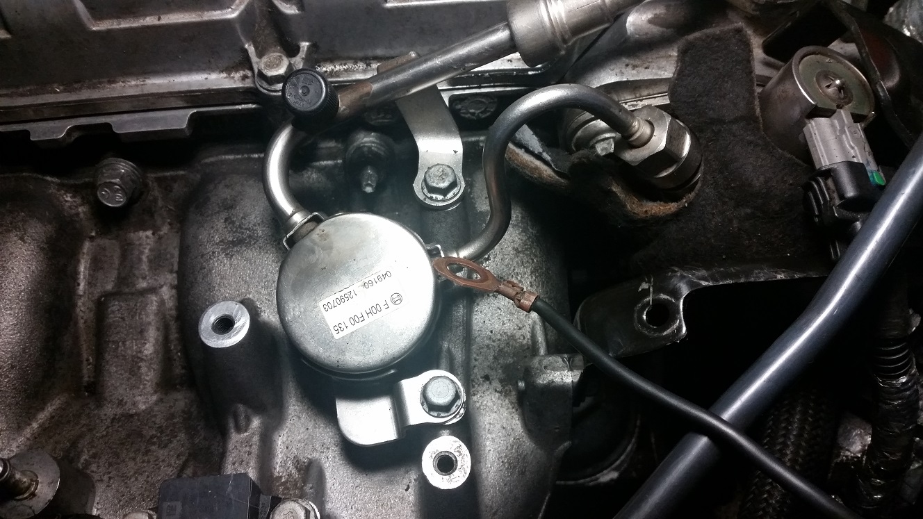

pic #3 = a wider shot of the location of the wire.

If you mean to say that wire is connected to the connector above the headlight, it probably goes to the bolt on the top of the trans. Maybe to the ECM.
Old Mar 22, 2018 | 07:58 AM
Posts: 39,979
Yup, ground to the stud on the front of the transmission just look down to the right of the oil filter. #3

I found the stud #3 in the picture you are referring to. I am confident the wire I need to connect does not belong there. I would have had no reason to disconnect it to remove the head.
The end that is still connected does connect to #2 or G103 in this picture. I am thinking either it is an SS specific wire - maybe high pressure fuel pump or something on the intake. I look under the hood of my dad's 2006 HHR with the 2.2L and it does not have the wire I am trying to connect.
Old Mar 23, 2018 | 09:25 AM
Posts: 26,482
The HPFP is mechanical.
Are there 2 wires connected to #3?
I am not aware of more than one wire connecting to G103. You seem to have 3.
I don't have an SS to look at, just going by what the book says.
I don't know of any wire connecting to the head besides a small one on the back passenger side on some cars.
