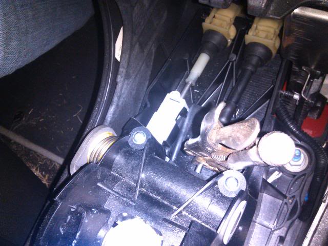

So, I went for a hard 1st to 2nd shift tonight and the car went into neutral even though the shifter was all the way into 2nd. No problem, I figured the cable has slipped or stretched, so I would adjust the clip for the linkage. Opened up the center console and discovered this:
Yep, bent the shift linkage, apparently don't know my own strength. Anyone know the part number for this so I can get it fixed up ASAP?

Don't know your own strength huh?
Give this link a look, it has the part numbers and a parts diagram for you.
http://parts.nalleygmc.com/showAssem...rimLevel=14421

Thanks for the quick reply. Looks like this is going to be a ***** to fix.

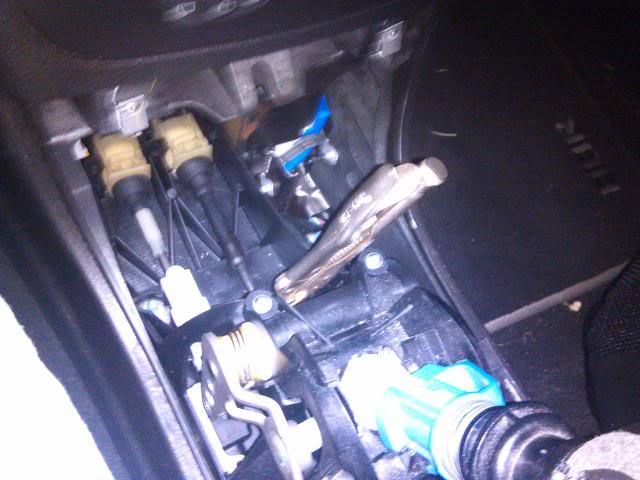

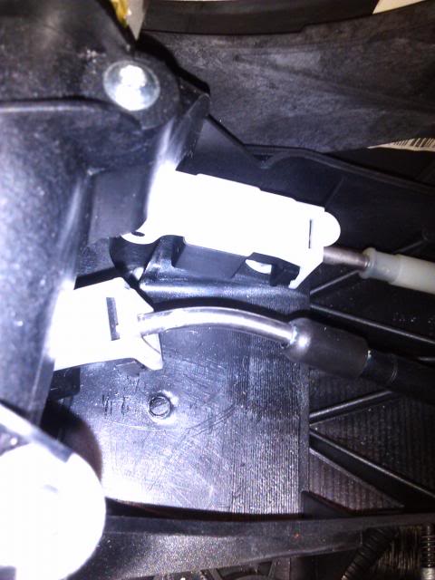

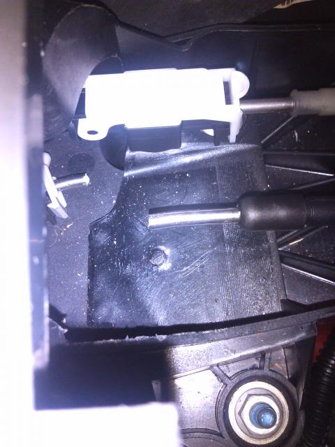

So anywhooo. Looks like just bending the rod back into place was only a temporary fix. The linkage broke completely on a 2-3 shift tonight.
Unfortunately it broke in while in the neutral position. After coasting off to the side of the highway, I was able to figure out a way to get er home.
Good ole fashioned vice grips. I also now know how to steer with my knees, and use both hands to shift (One for left/right, one for front/back). Looks like I'll be installing the linkage this weekend.

I've got the same problem on mine, the white shifter blocks come out of position and it feels like nuetral. I have to let it go back into the nuetral position and then it goes into gear. Mine only happens during "spirited" shifting. I haven't bend anything yet though :o)
Please take lots of pics as there are several of us with this issue.
