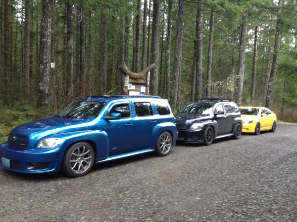

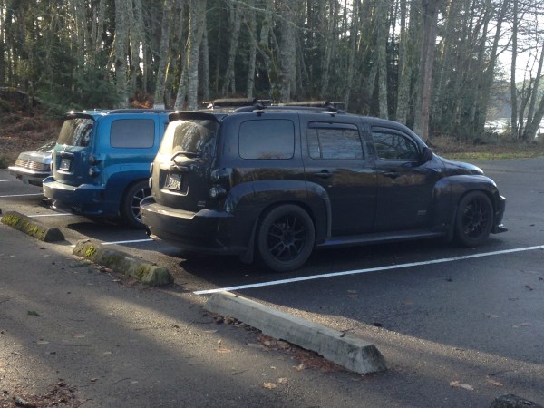

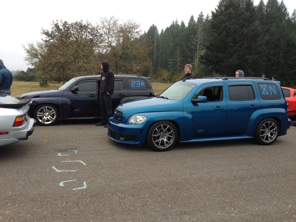

I'm confused (Not a huge surprise there)...which car IS the one running 245/45/18's, does it have stock suspension, and what wheels (size and offset) are they running?
Old Feb 25, 2015 | 09:52 AM
It has 8", 40 offset wheels and YYZv2 springs with fe5 struts.

I wish I could run that low, the stance is perfect. Unfortuantely, around here I'd loose the front facia (and intercooler) with-in the first hour of driving.
I'm hoping the larger diameter fits to fill the wheel well a little better and give a similar look without dropping it.
Old Feb 25, 2015 | 12:53 PM
We don't stay on the hwy or anything, but the stock height is about 1.5" higher.

The wheels on the black ss look like 17".
