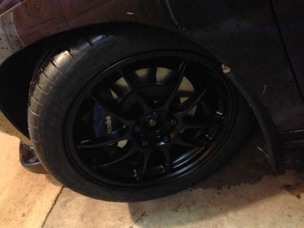

Old Feb 24, 2015 | 10:21 AM
Usually when there is a picture.........It did happen..............
Here it is rolling , just incase you suspect photoshop.........

Old Feb 24, 2015 | 01:00 PM
Those wheels have a 40 off set and are 8". You will just have to mount one up and see if it fits..What tires do you have, these are Michelins.
