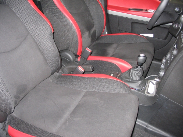

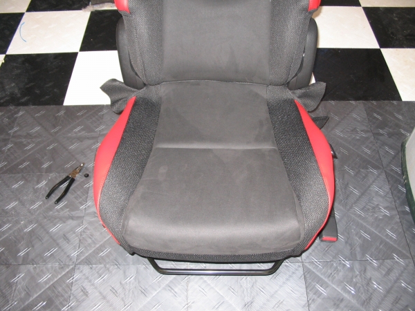

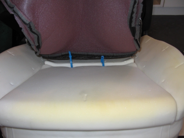

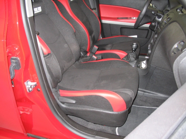

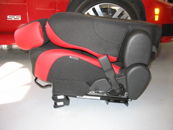

Finally got the foam seat base. Although the seat removal is straightforward, here is the process. 1) Slide seat all the way forward. 2) remove 2 bolts (18mm socket) 3) tilt seat forward and remove 2 electrical connectors, the large clip has a tab release to squeeze on the rt, the small one has a tab underneath. 4) fold seat all the way down if you have not already done that. 5) carefully remove through the door opening. NOTE: there are all kinds of sharp edges, so be very careful of your interior panels and lower body work and sills. 6) set seat assembly upside down on carpeted surface 7) remove seat belt nut (14mm socket). 8) Remove 2 phillip head screws at back of side plastic covers. pull covers away at back, slide the outside one fwd off the clip (careful). 9) remove the 2 clip rings and disconnect the 2 elastic bands 10) unclip all the plastic extrusions that join the seat cover to the sheet metal (these are a bear to remove, and very easy to install) you kind of have to roll, pry them off, I did it by hand, but a tool might help. Installation of the performance covers is a breeze, as all the clips line up just fine. Here are photos of the cover install with descriptions:
There are 3 retainer wire rods that need to be tied to the foam. I used zip ties as shown. Don't need to pull them tight, just snug. after you cut the ends, rotate the end down so it imbeds in the foam and can't poke into the seat cover.
Move this "skirt piece" to the side shown (use a seam ripper or (carefully) a razor blade to remove the stitches. Main thing is to cover the (unused) hole for the seat switch, the rest of the rail you can't really see anyway, but it duplicates the stock setup.
There is extra material at the 2 back corners, Better to leave too much and stuff it into the plastic covers, rather than cut away too much.
If you look carefully, you can see that the seat at the junction to the back is raised up slightly compared to the driver seat. This is because you need to carry it over the bar that is part of the "fold-flat" seat configuration. There is a foam piece that covers this bar that you will need to cut away from the stock passenger seat foam and install with the new cover. I contact bonded it to the foam and cover so it would not move out of place, but that might not be necessary. There is no "comfort issue" with the slight tilt to the back of the seat. Going back and forth between the two seats, I cannot feel a difference.
Complete and comfy and matched!
