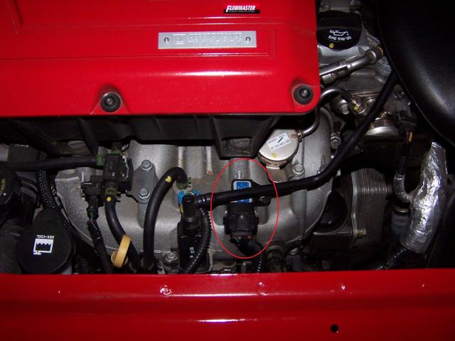

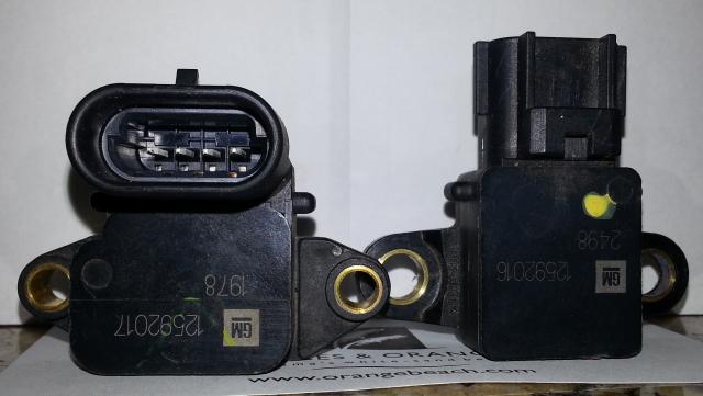

Really no need to check the Tmap sensor numbers. Just do a visual. The stock sensors are black with GM lettering. The GMTU Bosch sensors have a blue/silver sticker like below.
Awesome guys thanks for the info. I do indeed have the GSM1 on the car, I didn't get a chance to thoroughly inspect but I do know it was done by the dealer, the ECU has definitely been flashed and it looks like they used the harnesses instead of the cut and solder method.
What exactly will the GSM1 provide. From all the reading I've done it is basically a canned tune (supposedly with the learn down feature disabled or toned down) with 3 Bar sensors that will only help is a situation where I add more than 25-28lbs of boost. I came close to needing that on the Auto car. ZZP mentioned that if I did get the upgraded MAPs they could dial in the boost better especially on the higher side.
