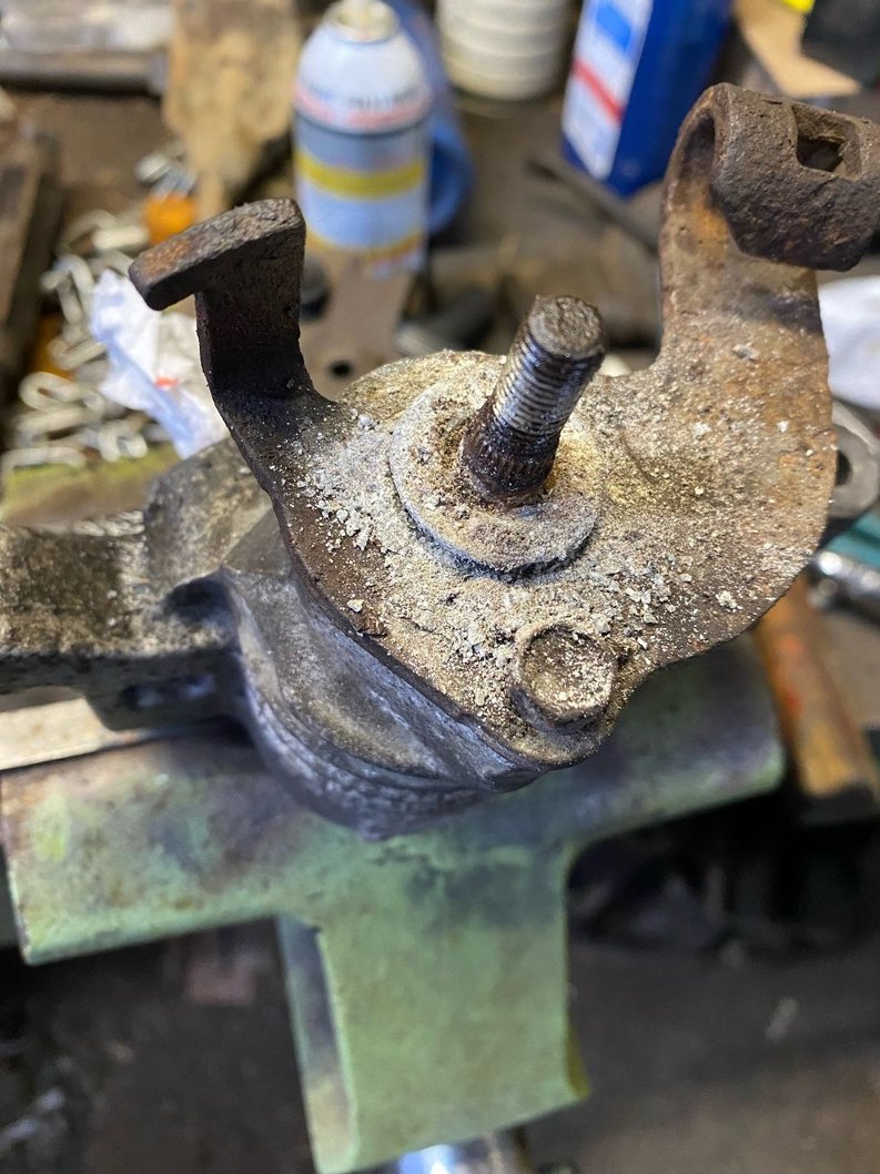

I finally got time to look at this. Lo and behold, there was a bunch of corrosion around the E-brake shaft. This is pretty irritating considering the caliper was not that old and was an ACDelco remanufactured replacement. Not to mention, the caliper on the other side of the car is original with 210K miles on it and has no issues.
I was able to clean away the grime and get it working again. I put a light coating of grease around the area, in hopes of warding off the problem later.
