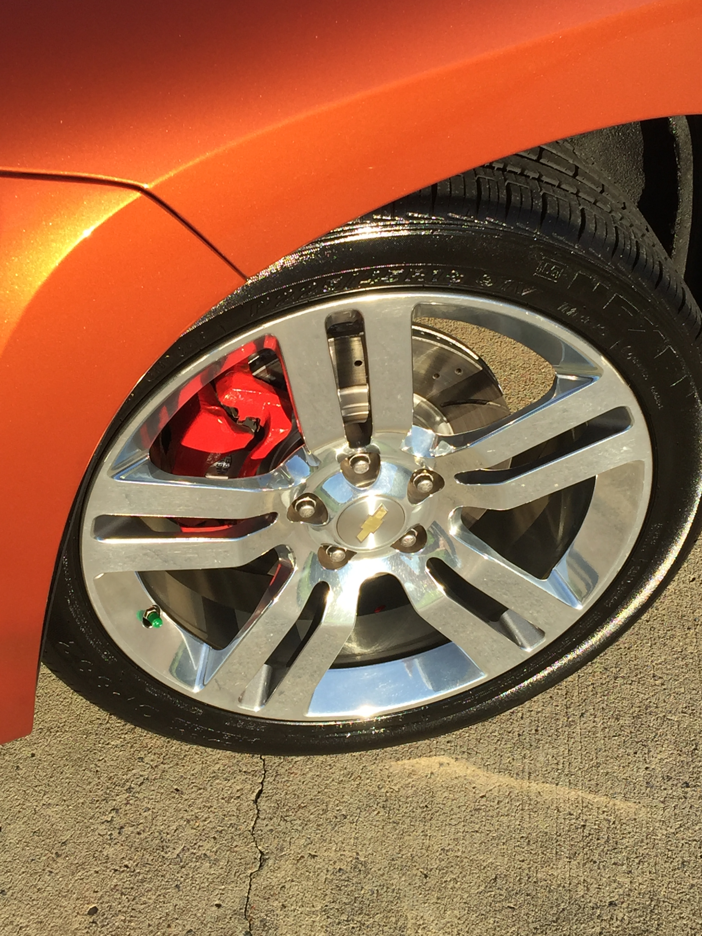

I have a 2008 SS and I need to replace my front brake pads for the first time since I bought it. My vehicle has drilled and slotted rotors. I was thinking of installing Dura Last brake pads from Auto Zone.
I'd like to hear your thoughts on this brand of pads particularly with the type rotors I have. Anything to be sure to watch for or watch out for?
I plan to do this soon so quick replies would be helpful.
