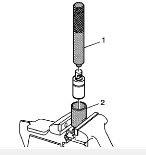

Quick update:
The replacement ACDelco tensioner arrived. I spent some time dissecting it on the workbench to see if there were any noticeable differences between it and the old one. I thought possibly that the spring tension of the old one had weakened. However, I found that was not the case. With a crude setup, using a bathroom scale on my drill press, I compressed both the new and old tensioners 1/8" (1/8" was the point where the internal ratchet bottomed against itself). Both exerted about 18 pounds of force. I carefully inspected the innards but didn't see anything noticeably different, except...the closure collar with its o-ring, was looser in the old tensioner (see the circled components in the attached images). The old one's o-ring seemed to be stiffer (i.e., from heat and oil exposure over time) and didn't set in the bore as firmly as the new tensioner. It had a little more slop than the new one. So perhaps the o-ring was not sealing as good as when it was brand new. *shoulder shrug*
Bottom line...several reports online and at least one person here, mentioned that replacing the tensioner eliminated the cold startup rattle. I think I am going to install the new tensioner and see how things go. Granted, my chain will need serviced, but I think I should be able to get another 20k miles out of it first. We'll see. I'll post back in a few weeks with an update on the rattle condition.

There is no "old" and "new" design!!!!!!!!
There is a VVT (hydraulic) design and a non-VVT (mechanical) design.
The VVT design works in non-VVT engines and has superseded the part number.
When the tensioner gets to the end of it's travel the chain and guides need to be replaced, it is not the tensioner's fault. The tensioner is not a wear part.
A tensioner in the compressed state (in the box, before installation) should measure 72 mm from end to end. A tensioner in the active state should measure 85 mm. If you reuse the tensioner it must be in the compressed state. There is a "special" tool for the job.
