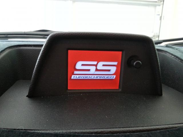

Posts: 11,721
If you don't have this on the dash, it's not a SS. All 2010 SS's came with these.

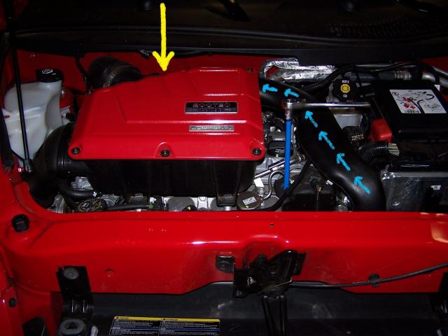

Posts: 11,721
Oops. Left off the 2nd picture.
Here's a underhood pic of a 2010 SS. Only difference is my air filter housing has been changed to red from the factory silver.
Blue line: turbo piping
Yellow: shows where the turbo is located.

Old Sep 30, 2014 | 04:41 PM
Posts: 26,542
So what does the Craftsman ratchet do? hehe hehe Do they all have that?
Just levity.
Old Sep 30, 2014 | 05:23 PM
Posts: 11,721
Yeah. You got me donbrew. And good eyes also because that IS an old Craftsman ratchet. That picture is actually about 4 years old. Back from when we were discussing oil filter sockets and such.
