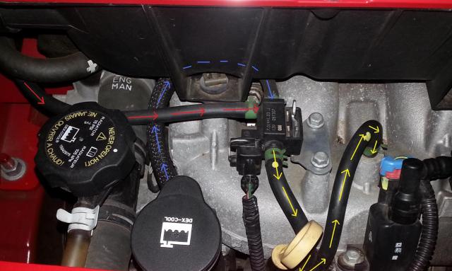

Dug up this old picture. There is a vacuum nipple at the lower Tmap sensor and 1 at the turbo bypass valve(BPV). Might be worth checking out your vacuum line connections.
Red goes to the BPV.
Blue to the lower Tmap.
Yellow to the vacuum reservoir.
(the arrows just indicate the direction of vacuum pull)
