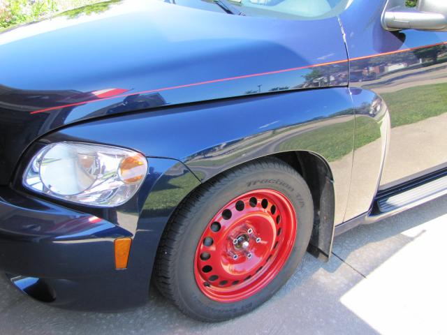

Old Feb 27, 2014 | 03:12 PM
Posts: 39,972
the 16" inch steelies, fit over the non Brembo 296 mm rotor brake set up, handle the potholes better than alloys and are fairly inexpensive!! here's a shot of my winter rims!
