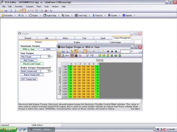

Since the LNF ECM is torque based, every LNF, is boost-ramped, or torque limited, in one way, or another, by the 'tune', factory, or aftermarket...
Boost-ramped is just a polite way that the 'tuner', is telling you, yea, I 'tuned' you, to provide your car, with more power/torque, but since you have wrong-wheel-drive, I'm going to take most of your awesome power/torque, gains, back, in 1st, & 2nd gears. Yea, that's what the factory GM 'tune' does too…
Here's what our stock factory boost-ramped curve, looks like:
Here's what my, NO boost-ramped curve, thru the gears, looks like:
So, the 1st, & easiest 'tune', is for your 'tuner' to spend 15 seconds, to change just this table, to give you full power, in ALL gears. You'll think that he is a ''god', but all he did, was to give you the power/torque, that you allready had…
Screw that, I want ALL of that gain, ALL of the time, I even want to OVERBOOST, thru the gears, to make even more, of that sweet,sweet, power/torque.
I'll deal with the power/torque gains myself, thru self-control, slicks, or hay, watch how I can toast the tires, on this little 4-banger ...
Since Trifecta has , 'select-a-tune', have them give you ALL of that power/torque, back, with a switchable 'tune'.
