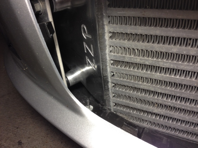

Yes the mesh fits. The only part that may not line up is the plastic panel underneath the IC. I got the panel back on without hacking it up, barely. This pic shows wut I mean. Very tight fit.

Yeah I read another member posted about the lower panel not fitting very well.
I will probably get the slightly shorter one from ZZP if I go this route.

The lower grille fits fine, I removed mine, then put it back in.
ZZP's new intercooler sits higher for increased clearance, I did minimal trimming of my shield for the big boy and painted the bottom line black to hide the corners that hung.

On mine I actually cut down the protrusions on the bottom and sides of the cover, and my grille still went back on nice and flush using the upper and lower mounting to the valance, I was impressed!
