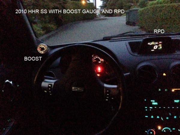

In an attempt to say "thank you", I thought some of you would be interested in the fun I had with the A pillar boost gauge project. Although I have the RPD box on the center of the dash (and like it), I normally have it set on the speedometer readout. Not only do I like the way the boost gauge looks on the A pillar, but what could be better than both?

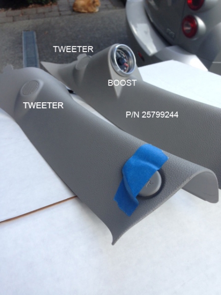

At first, I was just hoping to find the GM plastic trim that could support the tweeter and the gauge. And then find a gauge (and run a plastic tube thru the firewall to the engine). But things got exciting and a lot easier when I found that the RPD unit was an option on the 2008 and 2009... and standard on the 2010. This meant the boost gauge had to be standard on the 2008 and 2009 and most likely could operate at the same time as the RPD.

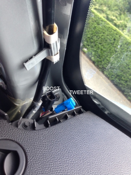

Then I struck gold when I found an unused connector at the base of the A pillar (see pictures)... possibly for the boost gauge. If true, this confirms that the factory boost gauge runs off the engine computer... not requiring a vacuum tube... and the lighting could all be handled through this connector!

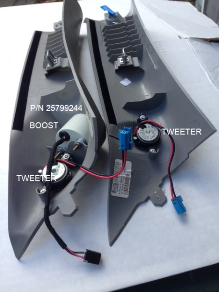

With the help of my Chevy parts man, I ordered P/N 25799244. It is the driver's side trim assembly that includes the light grey pillar cover; a tweeter (which I already have); and the AutoMeter boost gauge (all assembled)! And the whole assembly was only $150.00. It took me only a few minutes to install... and it works... boost and lighting!
Note: To remove the A pillar trim, gently pry off the "Airbag" cover piece and remove the screw (there is no airbag under the trim). When reinstalling the trim, you might find the tab at the base of the trim too thick for an easy install. I used a Dremel wheel to thin it out a bit.
