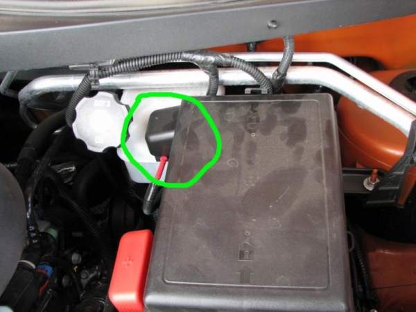

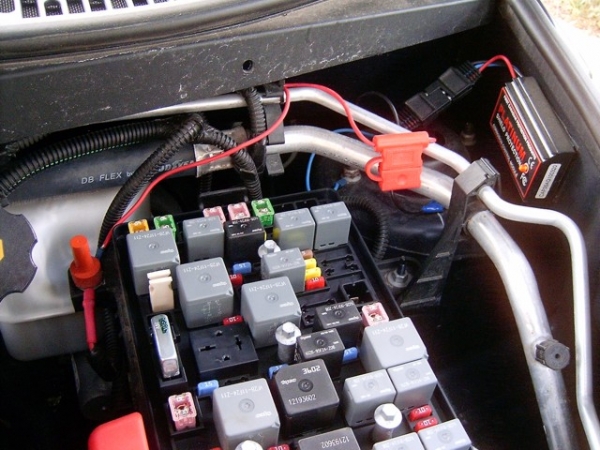

Originally Posted by jayras
Sorry for the confusion Deb.
In Mike's picture he didn't have a cap on it, so yo may not either..
But here's some pics to help guide you:
That little post is a power supply post for aftermarket parts such as my anti-corrosion module.
follow the red wire to the inline fuse and then to the black connection plug of the anti-corrosion module mounted on the right side wall.
