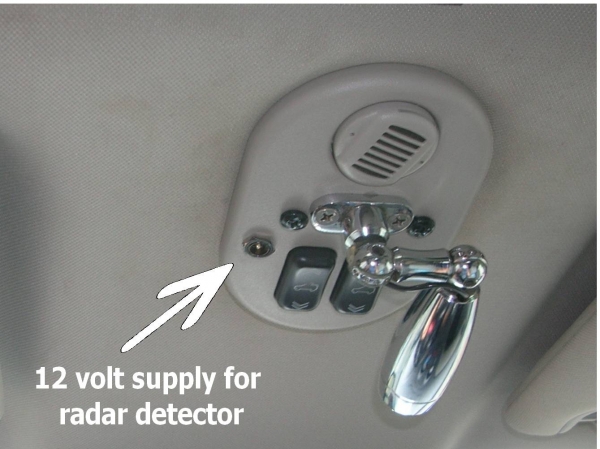

I wish I had known about the color option of the LED's. Then, maybe I would not have mounted my map light over the hole. At least I could aim it down to see the power window buttons.
I did install a 12 volt socket which makes for a neater power line for my radar detector.
[IMG][/IMG]

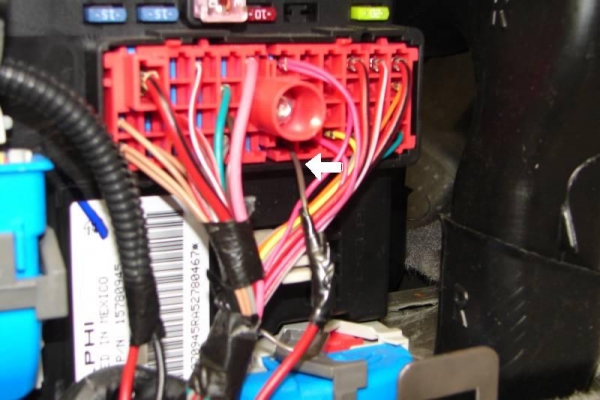

I have also added the El light string to my window switches, but I have found what I believe to be a better way to power them.
In the pictures of the interior fuse block elsewhere in this thread you will find the red wire connector that goes to the fuse block. Look for the dark gray/brownish wire just under and to the left of the mounting screw. This wire only goes "hot" when the headlights come on. That will give you a switched 12 volt feed whenever the driving/headlights come on. whether you turn the lights on or the headlights are set on auto. No worries about turning the lights on or forgetting to turn them off.
