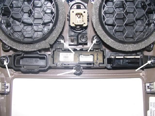

  2. Remove switch cluster. And the carefully remove the fog switch.
  3. Name:  DomeLite2.jpg

  4. Take the "button" off of the new hazard switch.
  5. Take the "button" off of the fog switch and put fog "button" on hazard switch.
  6. Put everything back together, and you now have an on/off fog light switch.
