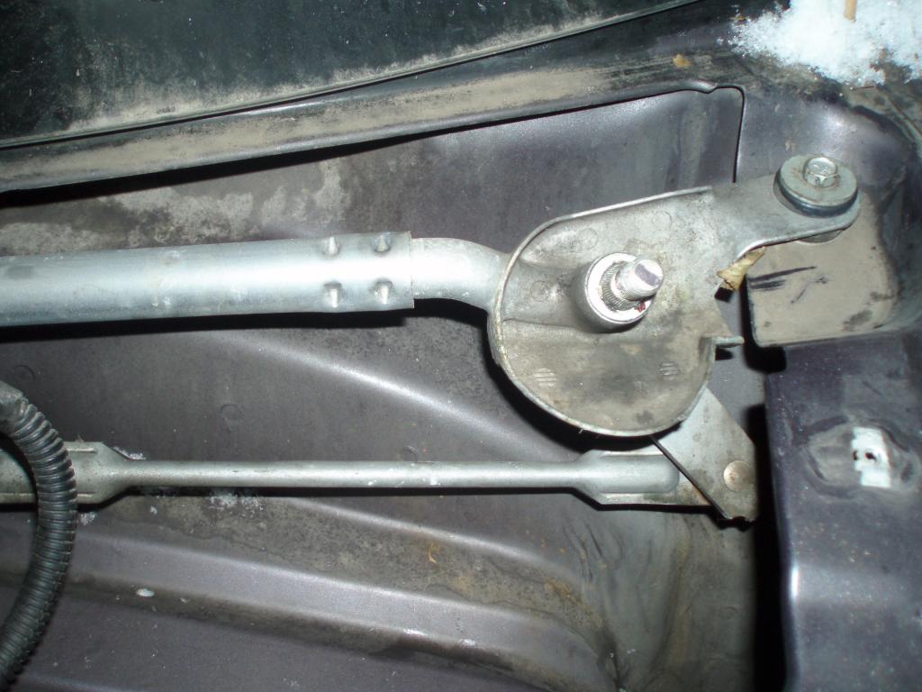

wiper end connector repair
I'm sure glad I saw this repair technique. My driver-side wiper went 'limp' while going 65 mph on the snowy highway yesterday. Sure enough, the little plastic end piece doesn't grab anymore.
In the process of drilling now and waiting for the drill battery to recharge.
I will probably buy three of those British clips once they let me know the nominal ball size it clips to.
Thanks for all the advice.
Here is what mine looked like this afternoon. I also (as someone else suggested) put some grease inside before assembling.
