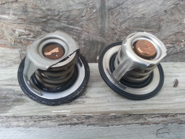

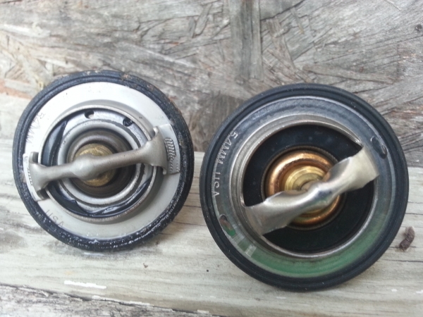

Problem solved. Not quite at easy as an old small-block Chevy, but not terrible by any means. Once I got the old one out, it was obvious that it needed to be replaced (old one on the left, replacement on the right):
Took it for a short drive and it got up to temp right away. Thanks again for the advice!

Just curious, what brand? The one that came in my 2011 does not have a large inner rubber seal, you can barely see it, it's not big enough to make a problem.
