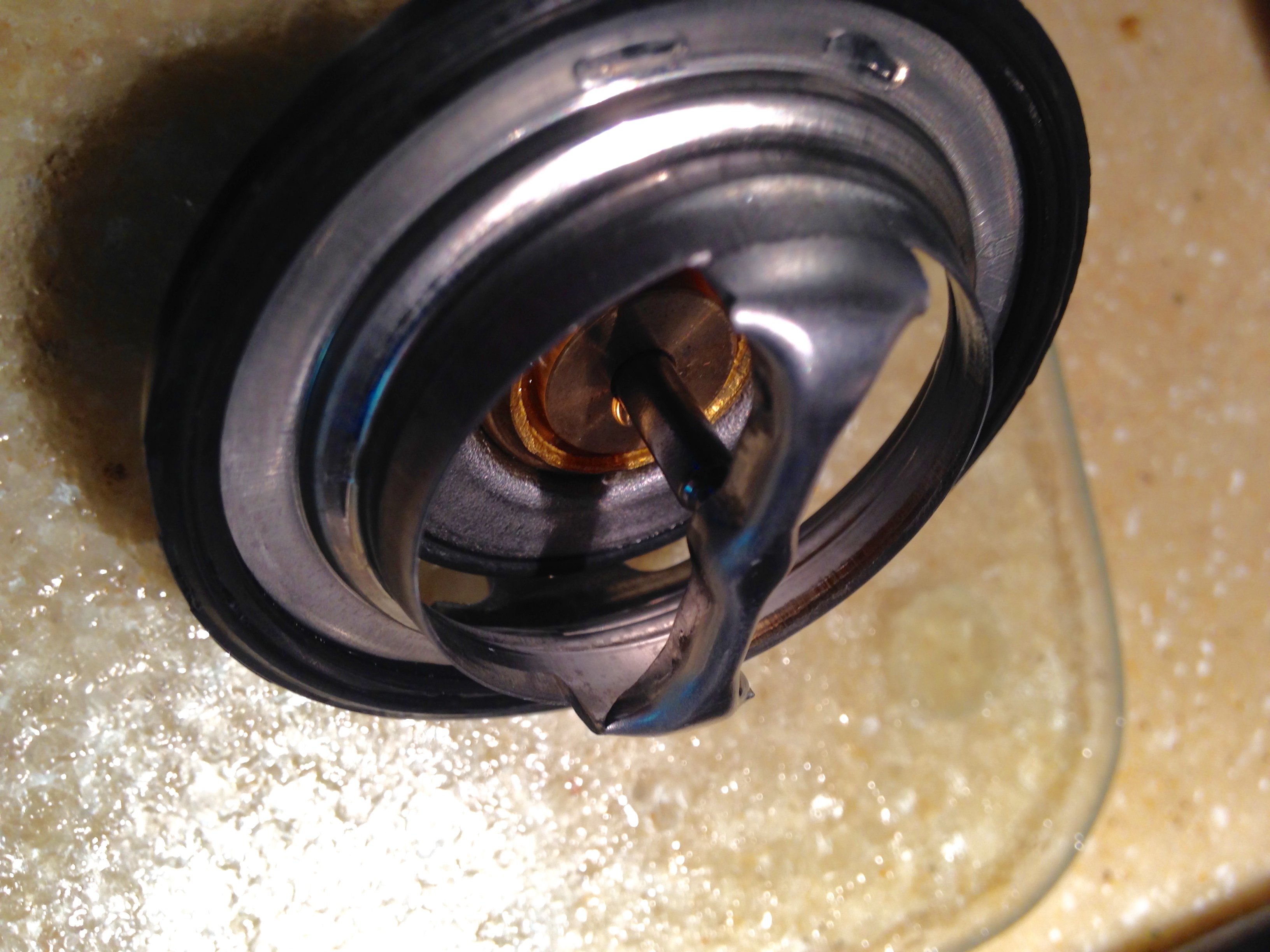

That is the old stock with the old rubber gasket so yup! Cowpie!

Originally Posted by JazzDad
I'm sorry to be beating this dead horse to death. (Wait, how can you do this?)
So which is the latest or best one: The 12T103D or the 131-158? One of the other moderators seems to favour the 131-158.
I searched here Search Chevrolet HHR Hatchback Parts
12t103d turns up no results, makes me think it's probably the older design.
131-158 turns up the thermo. But I couldn't find any pics online with the viewing angle that you took, to see if that inner gasket was there.
Now when I searched the ACDelco parts catalog ACDelco Parts , it says the 131-158 is GM original equipment, and the 12t103d is ACDelco Professional.
When I googled your 461-180, all I could seem to find was MotoRad.

This is my new thermostat. As you can see it's the 131-158 new style.
Look close it still has a small rubber o-ring.
$31.89 from rock auto. GM P/N 12622410
I'll give it a try and see what happens.
