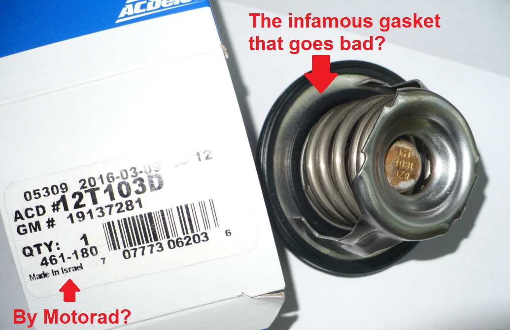

OK, am I stepping into the same cow pie again?
Did I manage to buy someone's old stock? It would appear it was made in March of this year.
